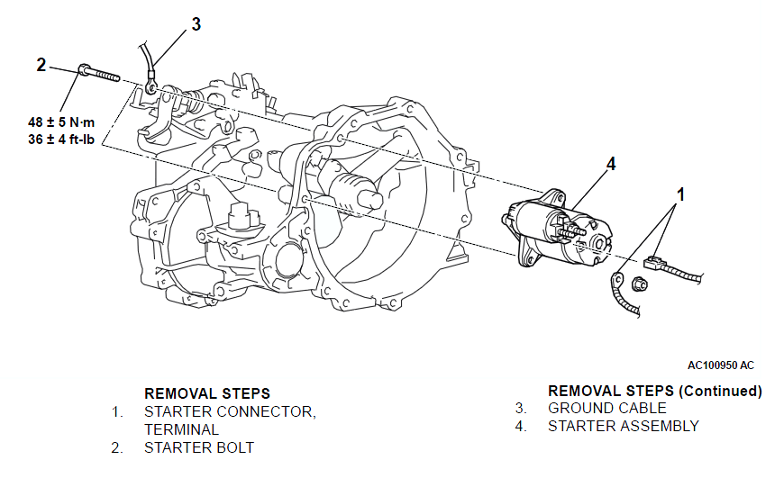

The starter is located on the back of the engine below the intake manifold right where the transmission meets the engine. There are two 14mm bolts that go through the trans housing into the starter. There is a 12mm nut that secures the 12v feed from the harness to the terminal on the starter and a flat spade connector that is connected to the solenoid on the starter.
Here's the view from the rear of the engine:
Old May 30, 2010 | 05:42 PM
bowlofturtle's Avatar
Joined: Aug 2008
Posts: 75
From: chicago
so i will be working out of intake box area to do the work? or should i go from under and behind the trans to pull it off.
picture is useless to me.
