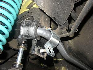

So like a week ago me and brian (urbanknight) intalled a set of pregress springs and sway bar on my car and after i noticed it hit against my greddy exhaust a lil bit but thats not the prob...a week goes by and the past 2 days everytime i hit a bump i hear a sound like my exhaust is going to fall off so i got under my car today to find this (see pix below) just woundering any suggestions. Thanks

nuts wernt tight enough prob

Might even want to use a bit of Loctite when you tighten everything up again.

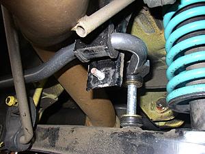

and this one is gone

crap, it looks like one of the brackets came completely off. The nuts are an easy replacement, but I'm not sure about the other bracket. But wow, I'm amazed those came off. I had you tighten them until they were "snug" and I figured a guy as big as you would do that easily. We'll see if we can order one of those brackets and then we'll get the right size nuts at OSH.

thanks for replying brian i knew you would be able to help me out. I hammered the one back in to place sort of and going to duct tape the **** out of it till we can fix it and for the ones that missing ill tape to it something solid for the time being. i was thinking we can maybe fix it when i get my new wheels. i'll talk to you more about it later
