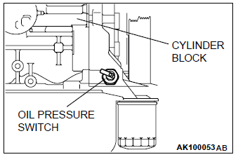

Yep. It's the oil pressure sensor. See the attached diagram for location. The diagram view is from the rear of the engine.
