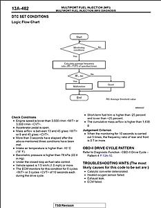

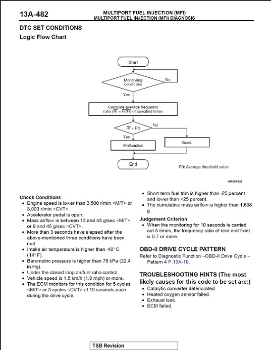

Throwing parts at a code hoping it will go away.....only a honda guy. You have to diagnose first, then replace the part!
P0421
Warm up catalyst efficiency below threshold
Here is the t/s info....good luck! You sure you can handle this...
I am also assuming you are out of the 7 year emissions warranty?
Attached Thumbnails Po421 code!!! =[-page1.jpg   Po421 code!!! =[-page2.jpg   Po421 code!!! =[-page3.jpg
