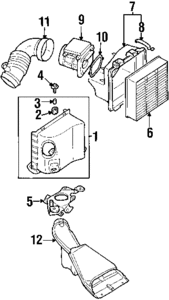

I need to know the part name or part number for #12
Im missing it off my car and what problems will it cause if im missing it

Its just an intake duck...Not having it, will not harm your car. In fact if you were to decide to switch over to a cold air intake style filter with a MAF adapter and filter the only 2 pieces you would keep are #9 and #11. .....

I'm an Auto as well, and I turbo'd my lancer. You can actually get adapter plates pretty cheap. I had one for a few months on my car before I did my turbo swap. Bought it on ebay for around $20.
If your interested here is a link to one like what I ordered. comes with both the adapter and filter. The only thing you'd to pick up at a hardware store is 4 nuts and bolts for a couple bucks since the ones on your car are a little short.
http://www.ebay.com/itm/95-99-Eclips...518129&vxp=mtr

Its just a box for the air filter. I got the above adapter plate on my lancer.

Yup its plastic :/ mine cracked but its still hanging in there. The setup goes air filter >adapter>intake tube. Dont over think it
