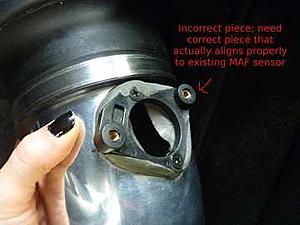

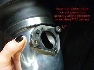

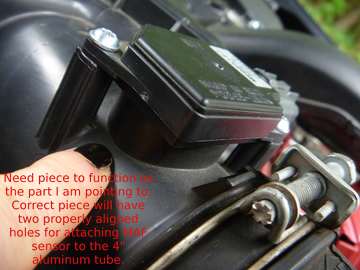

Heya Everyone!
Just joined and excited to see how we can help each other out. Made a custom 4" intake w/ aluminum pipe and just need the correct MAF sensor mounting bracket for the pipe. Summit doesn't seem to carry brackets that will work and I think it's coming down to more custom fabrication unless you guys know of an alternative.
Know there are a lot of kits with smaller diameter tubes that come with the mounting bracket/adapter pre-mounted, but I just need the individual piece to do the mounting myself. Suggestions/know where one might find a MAF sensor adapter/bracket/mount?
Thanks!
~LuckyLancer~

Thanks for the reply. Have that part sorted; attached are a few pics for clarification.
Attached Thumbnails 4" Custom Intake; MAF Sensor Mounting Bracket/Adapter-intake-maf-mounting-bracket-incorrect.jpg   4" Custom Intake; MAF Sensor Mounting Bracket/Adapter-maf-sensor-stock.jpg   4" Custom Intake; MAF Sensor Mounting Bracket/Adapter-maf-mounting-kit.jpg
