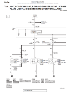

Here is a schematic. You just have to wiggle wiring or duplicate it to find the issue. Could be slight corrosion in connectors or loose pins.

after looking at the schematic. Since you didn't say that the license plate light is going out, then you can eliminate connector D14 or splice S065. Check the light connector and inside the light itself.
