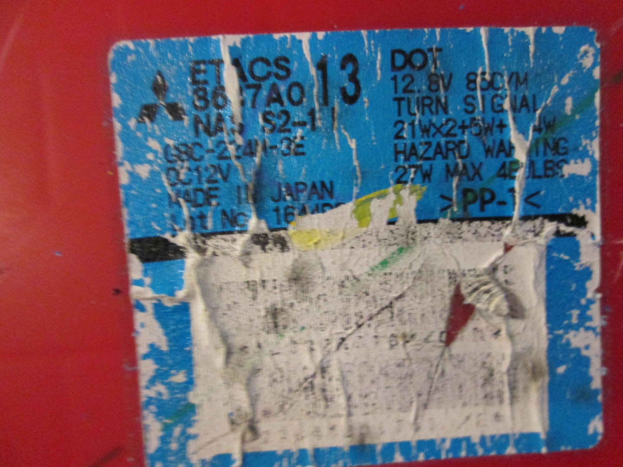

04 ES Just got this home today and need help on where to start. Turn signals and hazards do not work. No flash, click, nothing. I was reading some posts about a module
Part No: MR530918 / CONTROL UNIT, TIME & ALARM
Could this be it? Where is it? any way to test it?
Thanks looking forward to fixing it up.

OK I know where the unit is.

The ETACS ECU controls the flash and hazard, and is behind your in-car fuse panel...I'm not sure what you mean by pushing on the windshield.....

Thanks, I found the ETACS what does this stand for, I mean each letter must be short for something. Is this the only option I have is to replace this if hazards and turn signals are not working? Not that it will be hard just trying to get a consensus that this is a common problem and fix. This is a father son project and I want to make sure it all works for him. First picture is the car. Second picture is the windshield with me pushing out with my left hand while taking a picture with my right. Windshield is cracked and will need replaced that is why I even pushed on it to begin with, looks like it will come out easy...LOL I would welcome wheel suggestions and pictures, Not looking for top dollar wheels.

Electronic Total Automotive Control System...yes it controls the hazard and signal lights.
