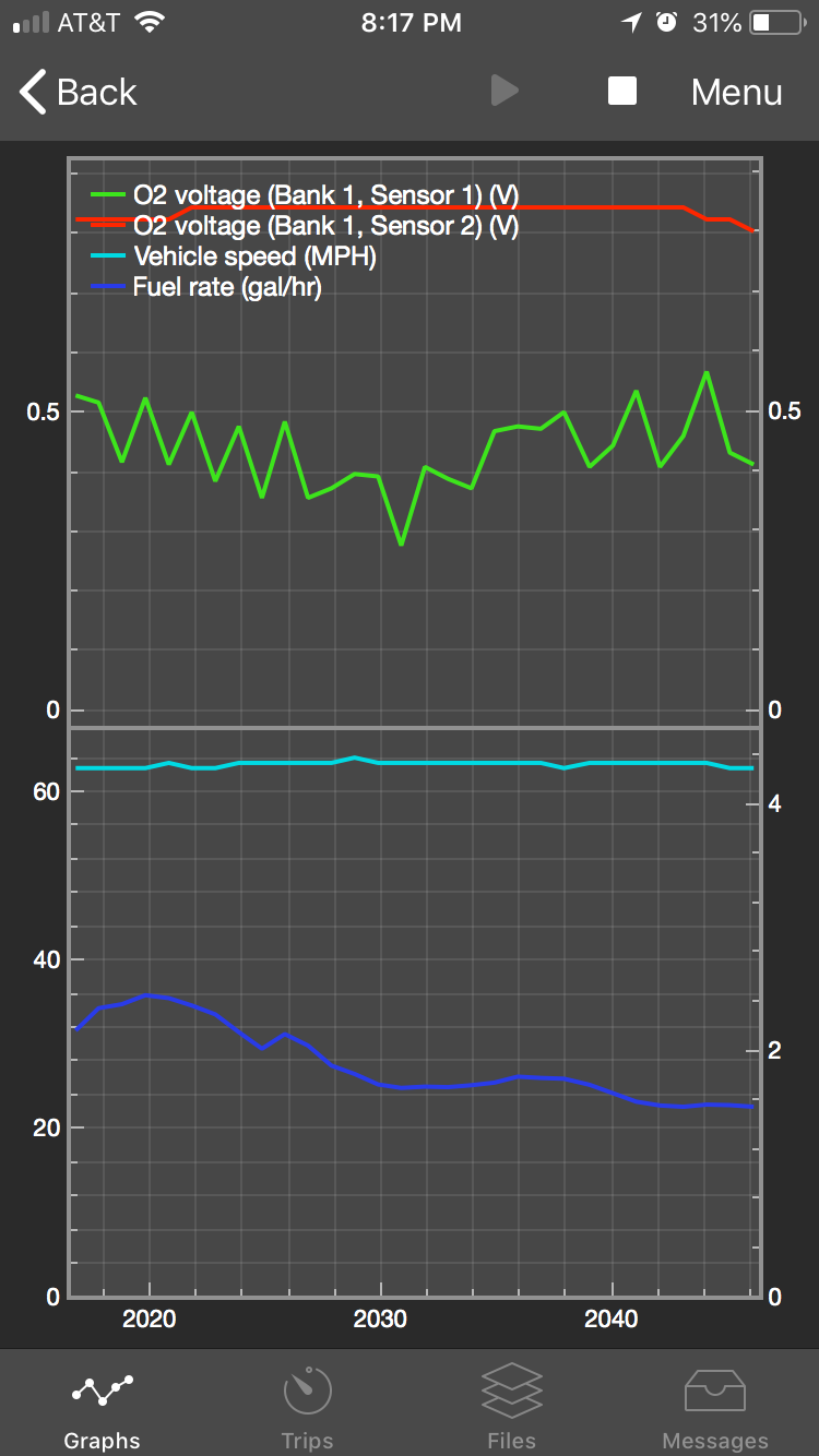

I had the same code. I replaced both exhaust manifold w/ built in CAT and the catalytic converter located under the vehicle. For the exhaust manifold, I replaced it with the OEM updated one as the original exhaust manifold had a recall or tsb on them and I replaced the cat under the vehicle with Magnaflow (CA Approved). Three months later and no error code
Here are the graph examples (before & after) of a bad and good CAT
1st Graph: Bad CAT= Bank 1 Sensor 2 (O2 sensor under vehicle) imitates Bank 1 sensor 1(O2 sensor under hood)
2nd Graph: Good CAT= Bank 1 sensor 2 (O2 sensor under vehicle) is constant as Bank 1 sensor 1 (O2 sensor under hood) fluctuates normally
