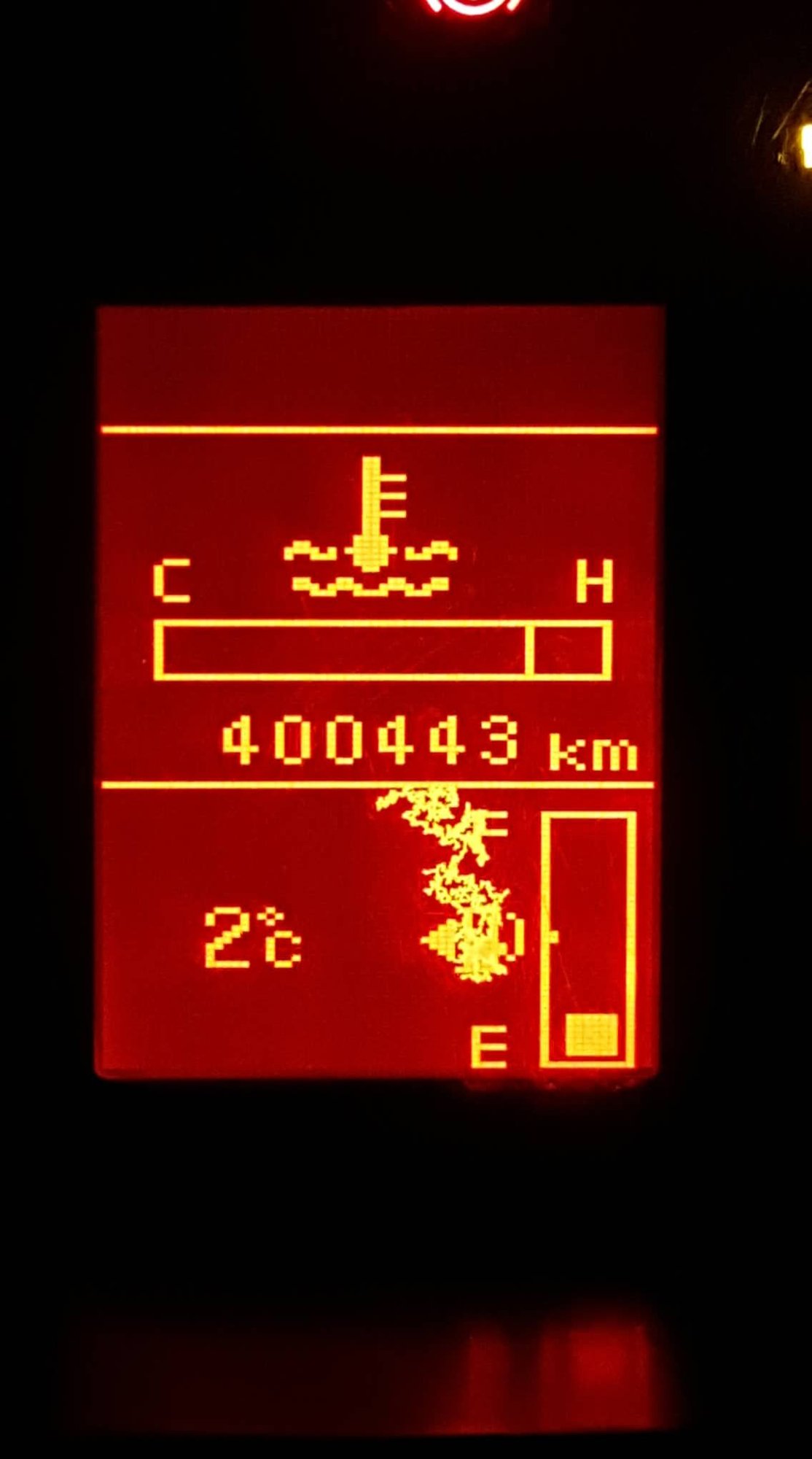

Hello,
i have a problem with my LCD display between the speedometer and the tachometer , it has a pixel problem i dont know how to call it (image attached) its really annoying
anyone knows how i can fix it by my self or other advice?

Wow that sure is annoying!
Judging by the second image in this post, I think you could replace just the LCD but you'll have to find a donor instrument cluster somewhere. Alternatively you could just swap out the entire instrument cluster for a new one, and maybe get a newer model with the colour LCD while you're at it. They are supposedly a direct swap. Be aware that the value of the ODO meter is stored in the cluster, so if you decide to change it to a new one this might be an issue.
