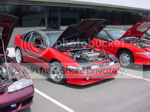

Hello Everyone I figured That I would make a little Log and maybe even give a little history of my car
bought it in 2001 ALL stock even had the air filter car the car had 130k on her
after watching a few movies and becoming a ricer the car had a few weird asthetic mods
At this point the car had 3 inch exhaust, hard piping, a 16g, and an afc
Then I had the unfortunate accident of an oil filter coming loose so I ended up stripping a timing belt.
here are some pics of her with the 16g and badd *** head

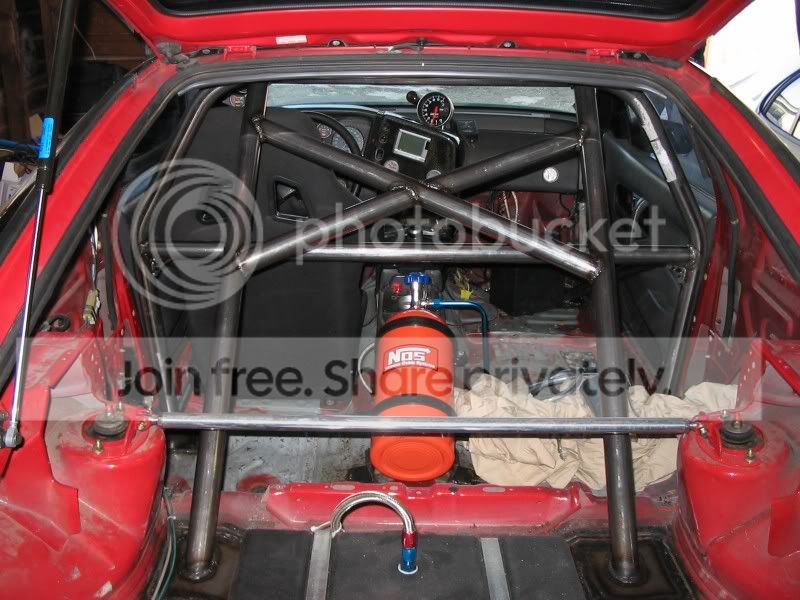

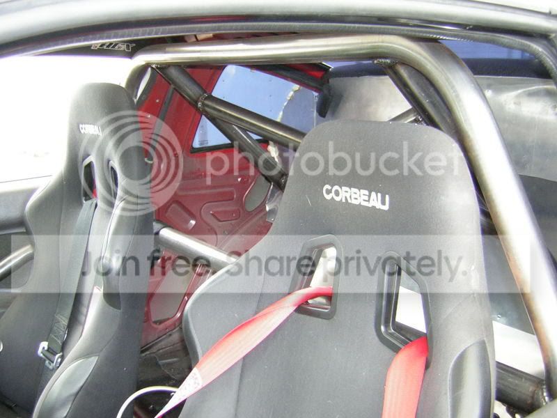

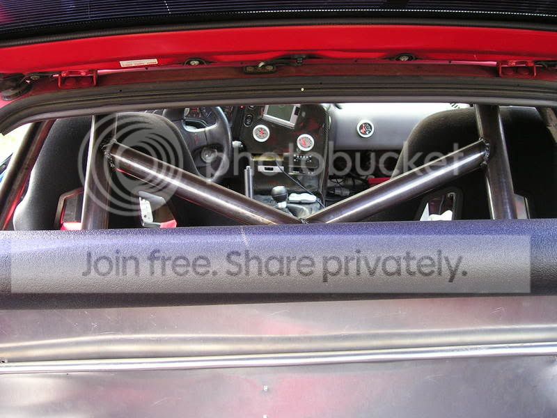

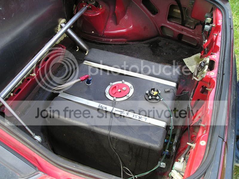

so I got a good buddy of mine to weld in a cage and this is what she looked like (thanks alot scott)

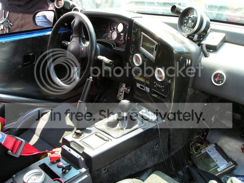

here are some random pictures of what she had including the ghetto fab rear firewall

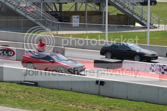

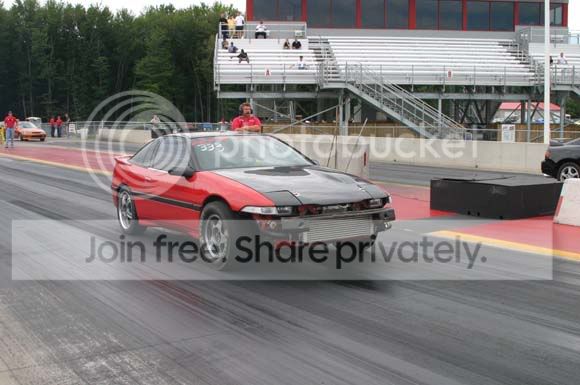

here she is at 131 with the T70 set up
ran a best 11.42 @132
hey look its BILL (showdowns old car)
I won that race because bill was having some problems with his car

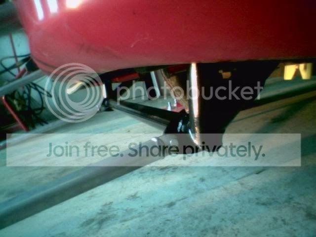

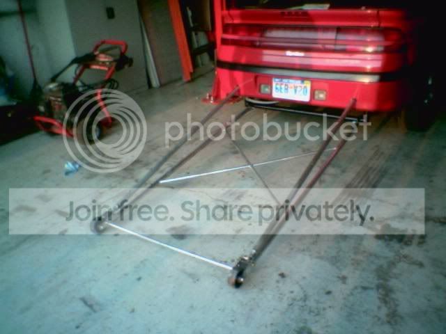

it was time for some wheelie bars so the crew at PMAS fabbed up some great wheelie bars for me

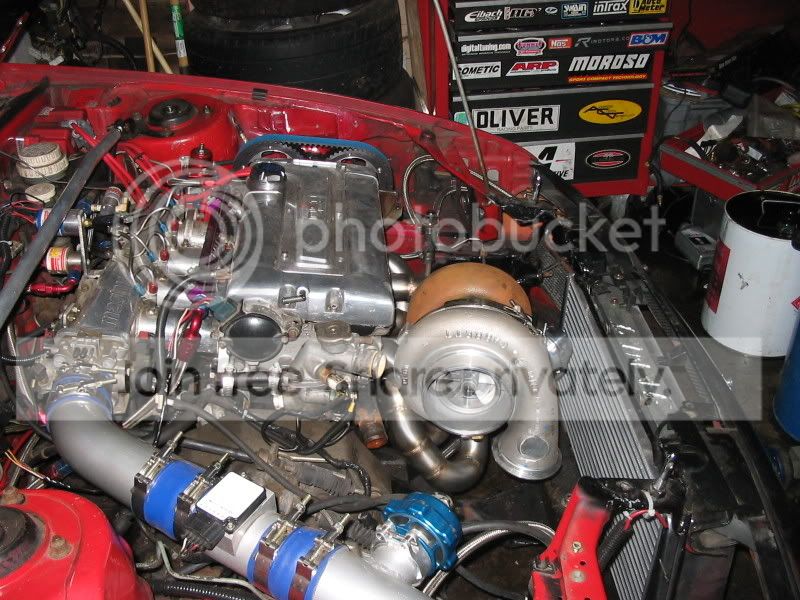

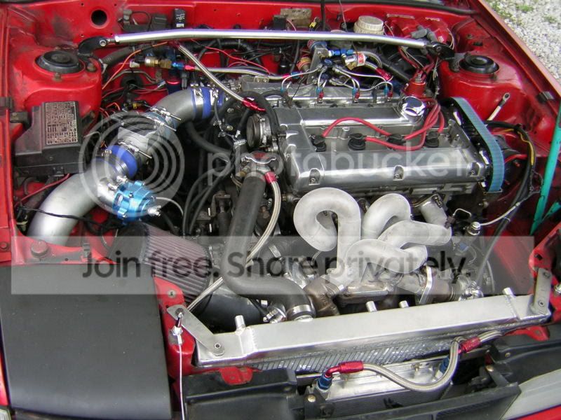

after some heavy massaging etc etc I decided to go with a real turbo so a 42 is what I choose

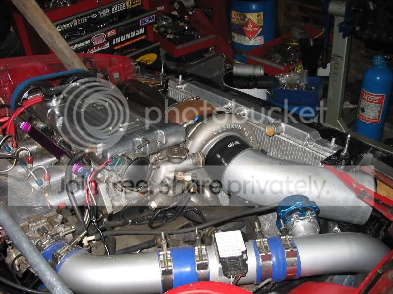

how she sits today
with the new front mount

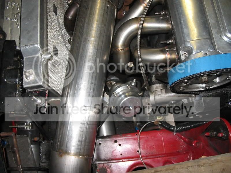

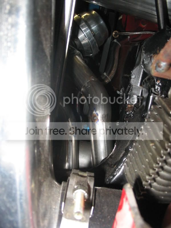

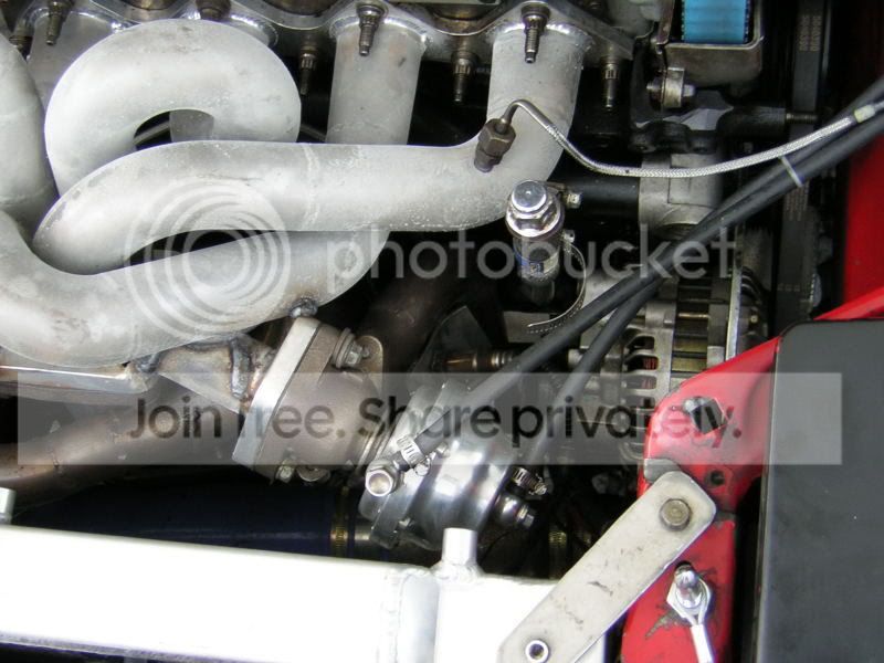

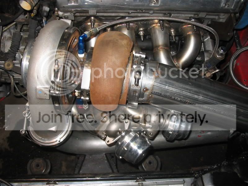

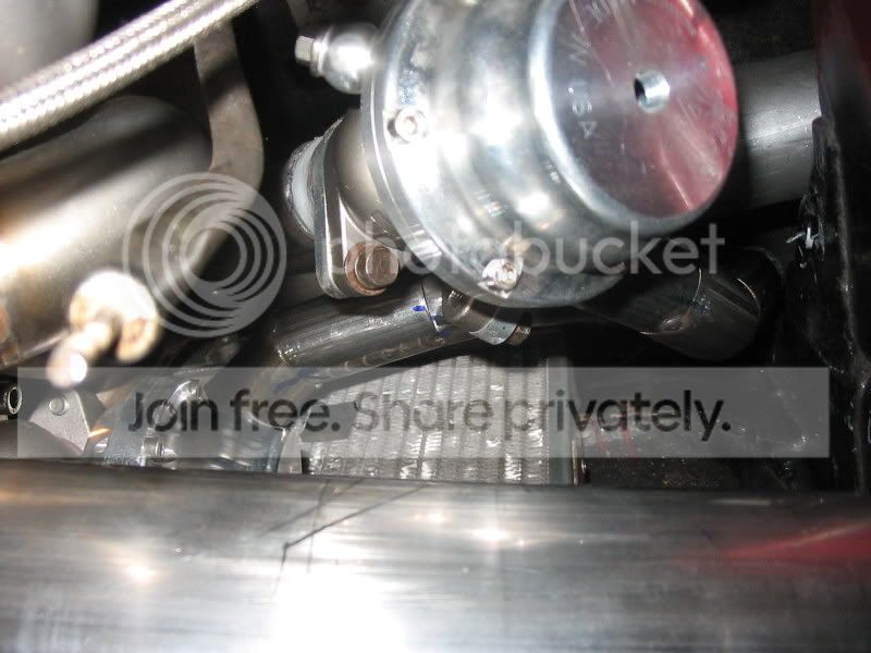

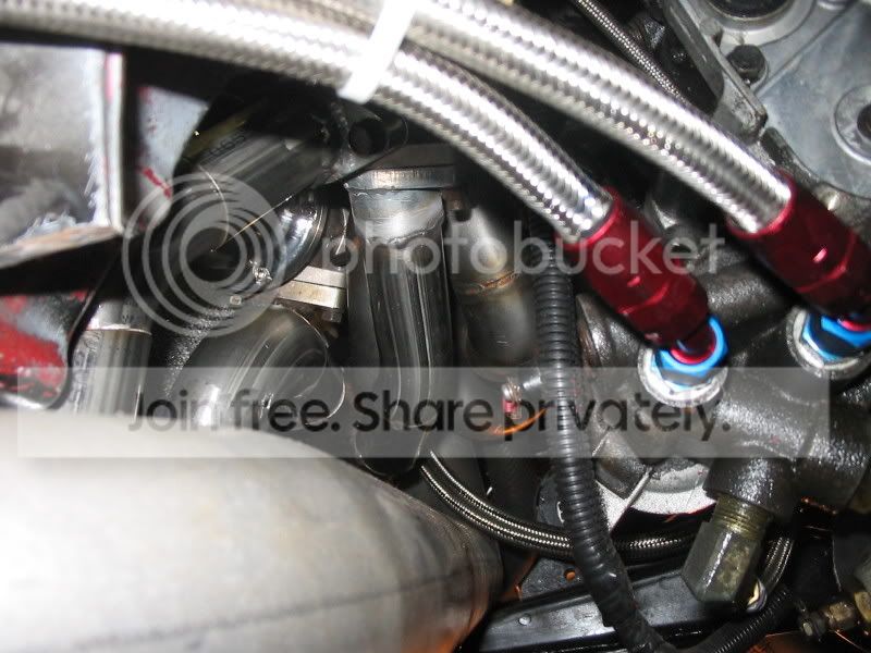

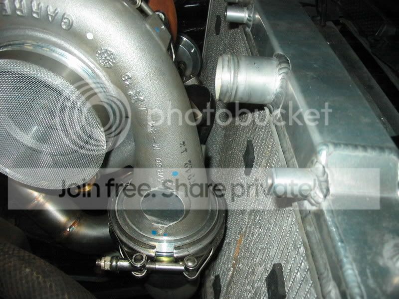

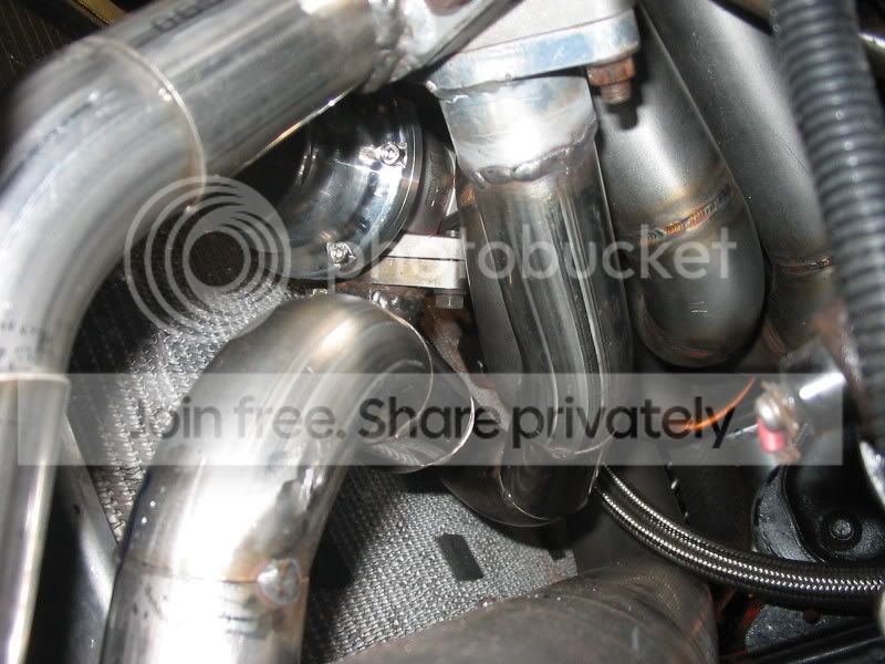

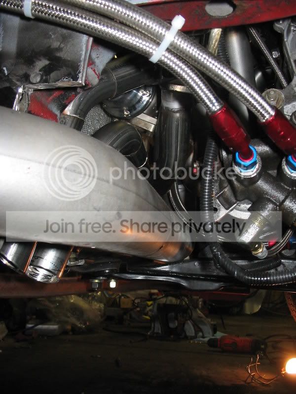

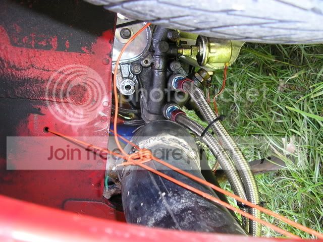

well I did not like how close the relocated gate was to the oil filter so I moved it up a little higher in the engine bay. I actually prefer this location, plus it gave me a better angle for the dump tubes from each gate to keep them relatively uniform and in the same location.
here are some pics of what the gates look like with the dump tubes attached
the dump tubes if you were looking straight through the bumper

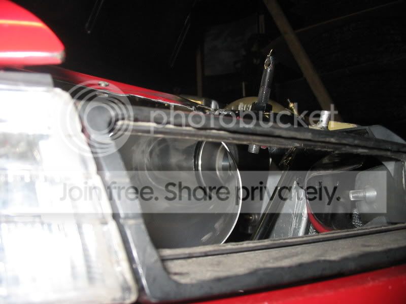

Next on the list was some kind of an intake system for the Gt42 well the inlet was 5 inches so I ordered up some 5 inch aluminum pipe and cut it the orientation that I wanted. This was quite a challenge to cut such a large pipe with my 14 inch chop saw, but it turned out "ok" I will be welding a Velocity stack that they use on carburators (sp) to it as they also have a foam insert inside the velicity stack
heres what it looks like now (the velocity stack is not yet purchased)

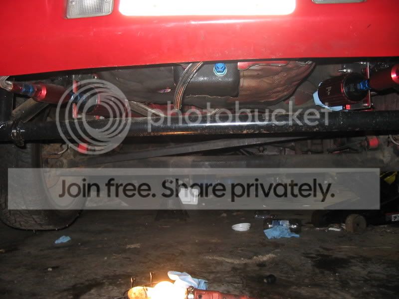

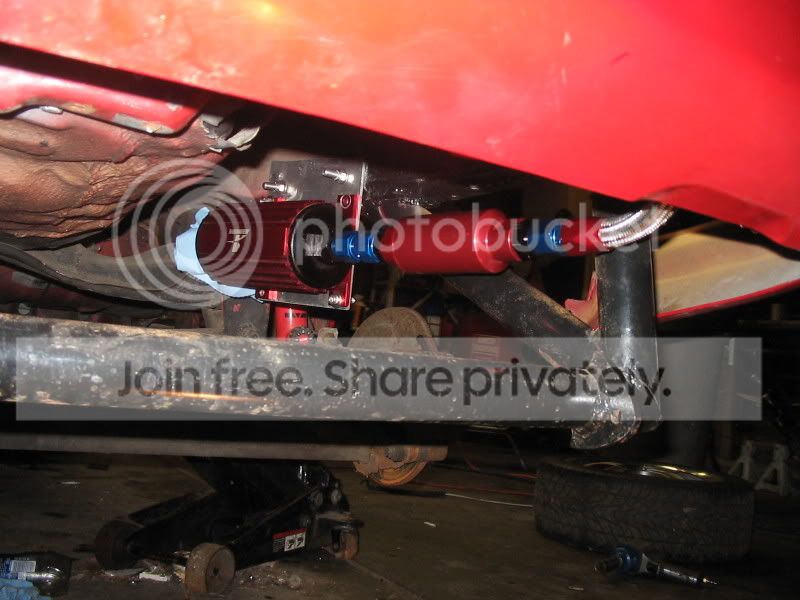

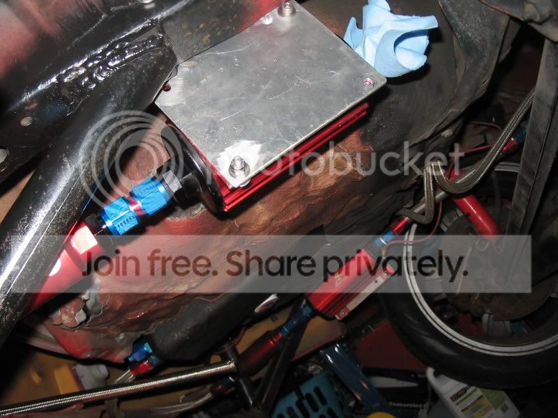

I also mounted up the second a1000 to the chasis, I have not run the lines into the existing system yet as I ran out of money for fittings and check valves 2
looking mean
