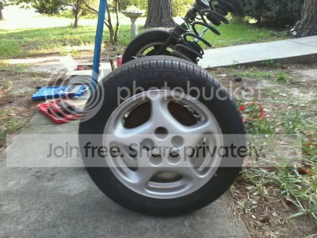

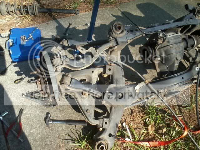

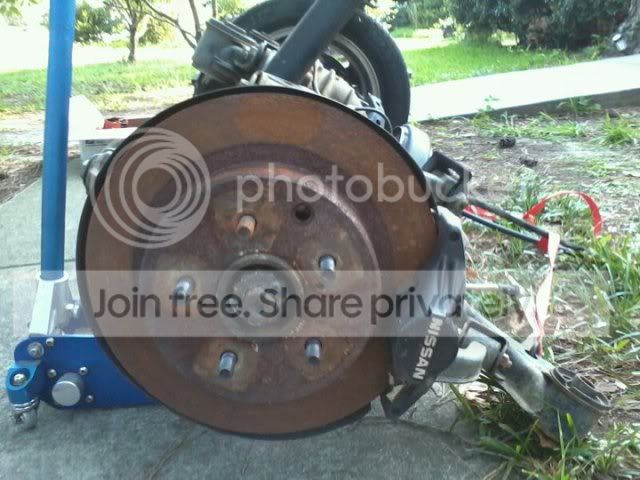

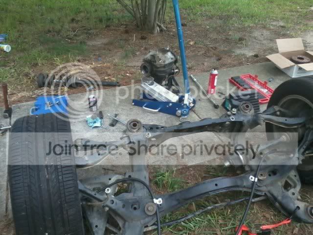

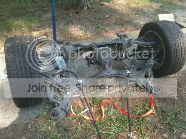

Getting some work done on the passenger side of the rear sub-frame.
Goodbye rusty old rotor

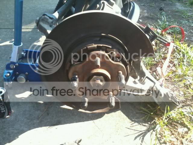

Axle is out

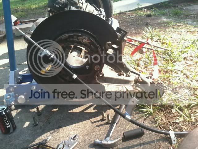

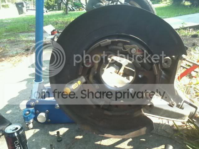

Removing the remnants of the old e-brake cable which was cut off six inches past the assembly.
New R33 e-brake cable, will route the same way as the s14 cable, is the correct length, but bolts right up to the Z32 drum style ebrake.
Put back together, halfway

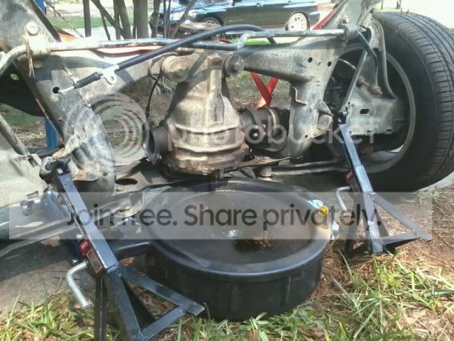

Time to drain the pumpkin

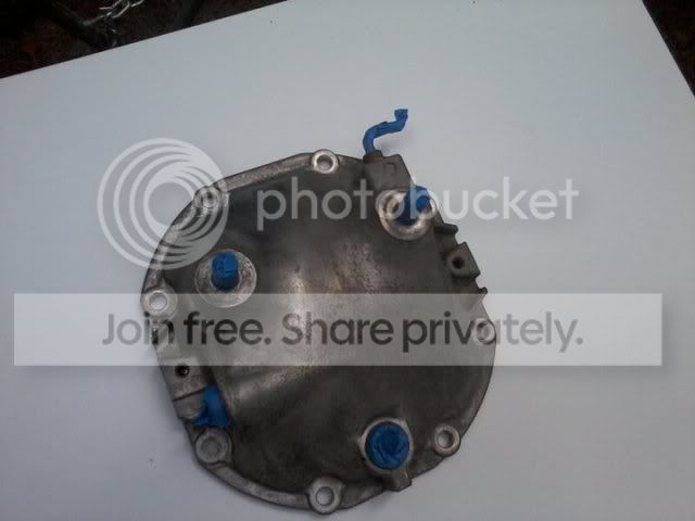

Getting ready to take the cover off

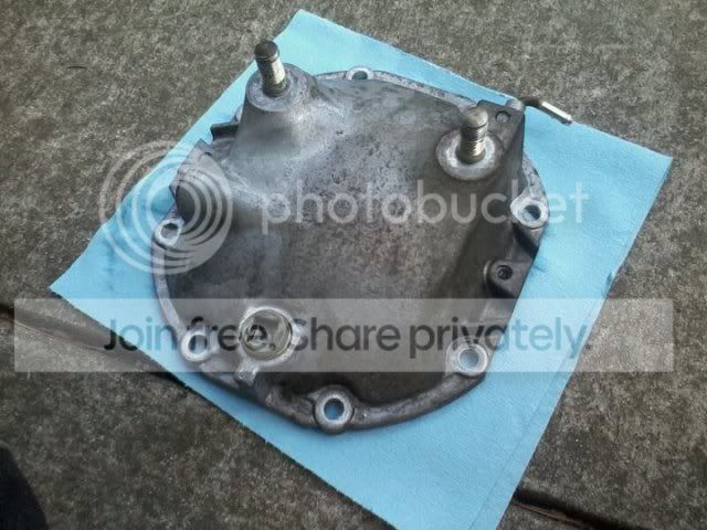

Cover is pretty well cleaned up, and has had all of the old gasket removed.

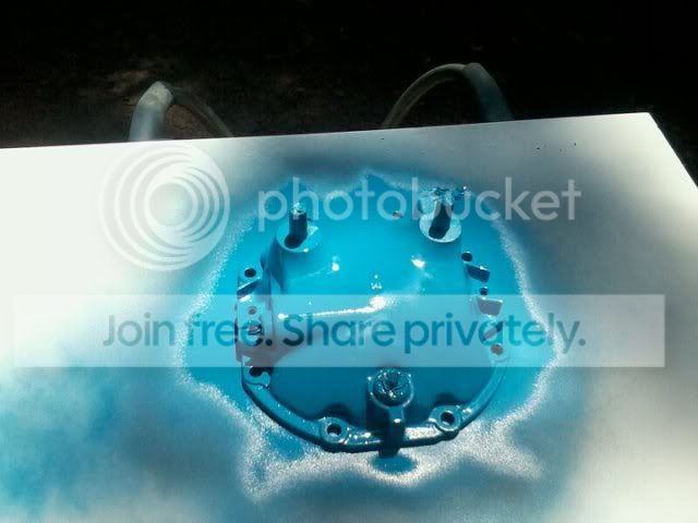

Prepping for paint
Should make it a little easier to spot any leaks on the differential, let's hope there aren't any!

The old gasket has been scraped off of the pumpkin.
The robot face has ears again!
Cover is back on, locked down, sealed up, and just about ready to go back into the rear subframe.
