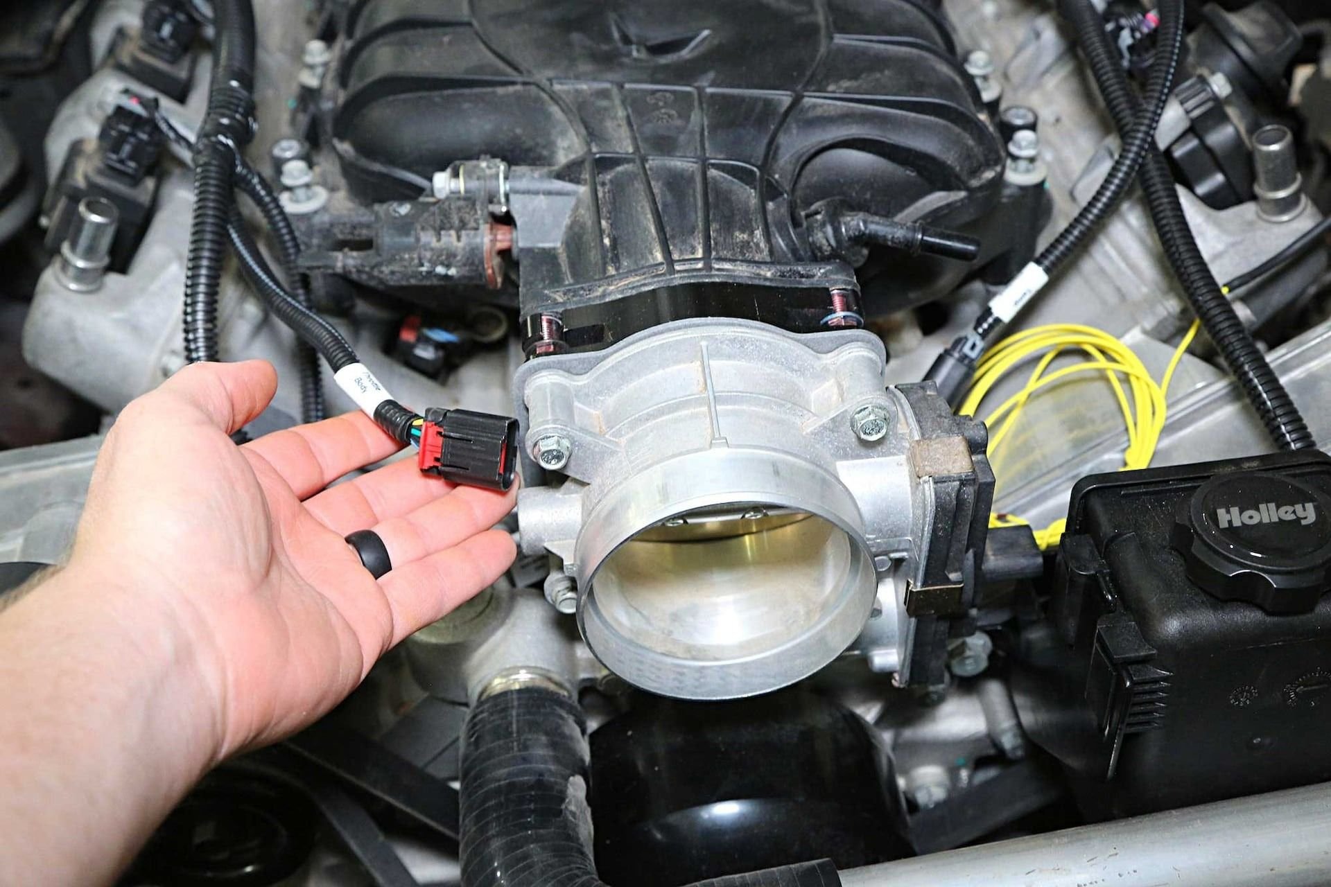

Step 1: Locate and Disconnect the Throttle Body
Start by locating the throttle body under the hood. It's the component that’s normally located between the air cleaner and the intake manifold on fuel-injected cars.
If you're unable to identify the throttle body, ask someone to step on the gas pedal while the engine is off. This will cause the throttle shaft to shift noticeably, as it's connected to the accelerator.
After you've located the throttle body, disconnect the battery as a safety precaution and ensure you've turned the engine off.
Remove any hoses and ducts connected to the throttle body. You could label them with masking tape first so that you know which hose to connect to each coupling when you reattach them later.
To remove the air intake tube, use a Phillips or Torx screwdriver to loosen the hose clamp. Gently twist and pull the duct until it comes off. Be careful not to disconnect any electrical wires or terminals in the process.
Sometimes, the throttle body has two air intake tubes, one on each side. In this case, you only need to remove one of them to expose the throttle for cleaning.

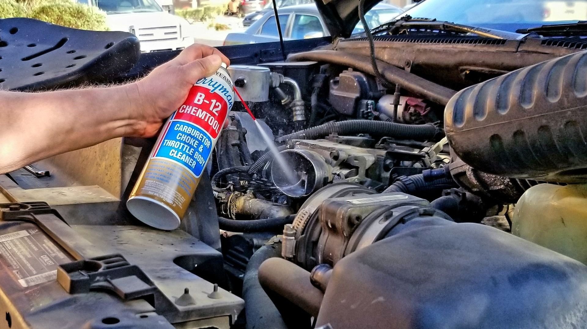

Step 2: Spray Cleaning Solution
Put on your rubber gloves and eye protection before applying the cleaning solution to the throttle body. This will protect you from the hazardous chemicals in the cleaner.
It's fine to spray the cleaner onto the butterfly valve with the assembly in place. It won't cause debris to fall into the engine as long as you don't overdo it. You need to clean both sides of the valve. If your vehicle has a cable-driven throttle, you can open the valve by hand.
Things get a little trickier with a drive-by-wire throttle body. You can't open the valve by hand, as it can damage the system. Instead, depress the throttle pedal. You can do this by placing something heavy on the gas pedal to keep the valve open or asking someone to step on the pedal.
After applying the cleaner, let it soak for about 10 minutes before cleaning the throttle body.
Step 3: Scrub Away Debris
Follow this guide on how to clean the throttle body without removing it:
1. Gently scrub the inside of the throttle body with a toothbrush to loosen any dirt, varnish, or gum. This is also an effective way to get into hard-to-reach crevices.
2. Use a rag or paper towel to wipe up the residue. If you see any remaining buildup, continue to spray the cleaner, scrub, and wipe until the metal is clean and bare.
3. Be careful to avoid getting cleaner on the sensors during the cleaning process and clean up any liquid or residue that may have spilled onto any of the surrounding components, such as the engine.
4. When you've finished cleaning, lightly lubricate the throttle shaft to ensure smooth movement. Use a cotton swab to apply a small drop of general-purpose oil at the points where the shaft enters the throttle body.
