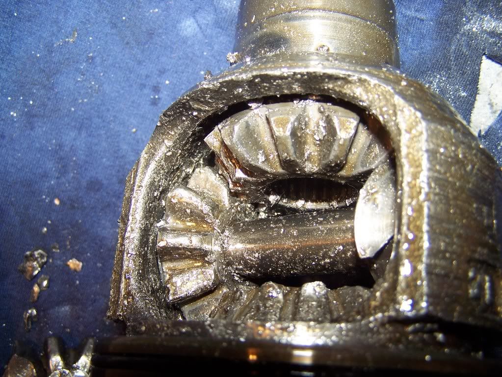

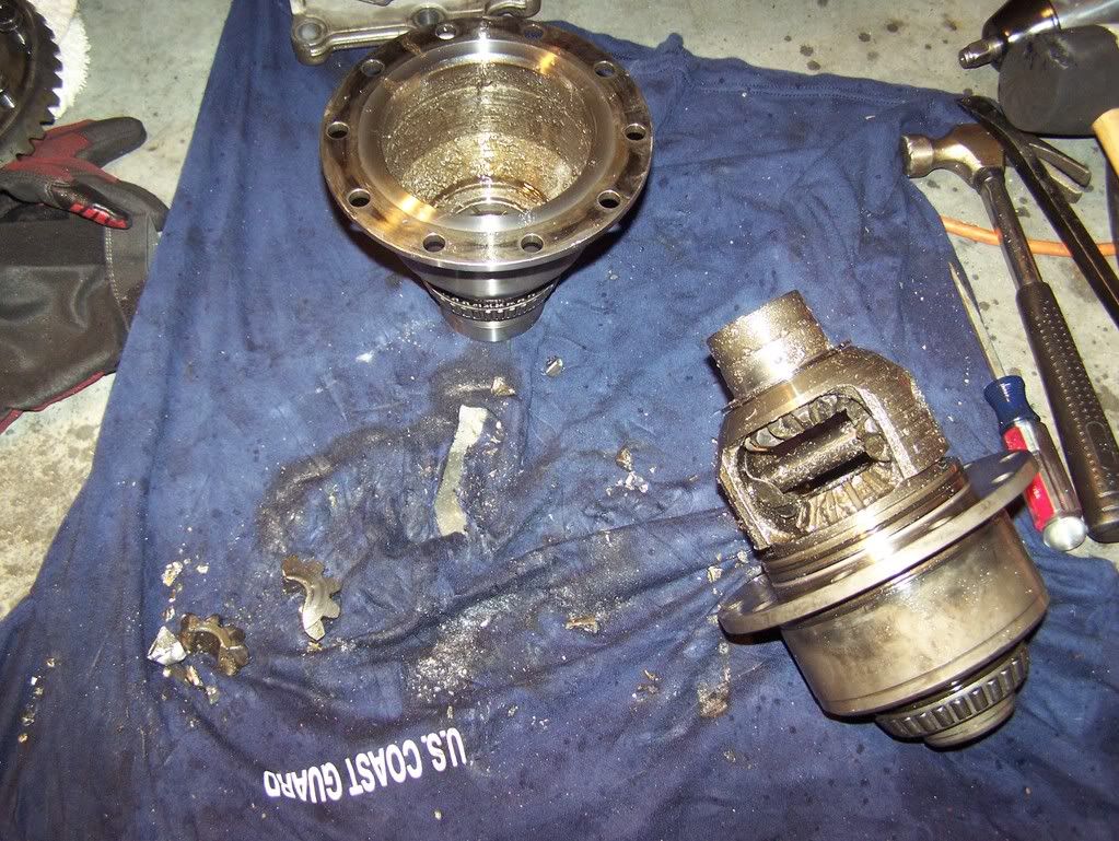

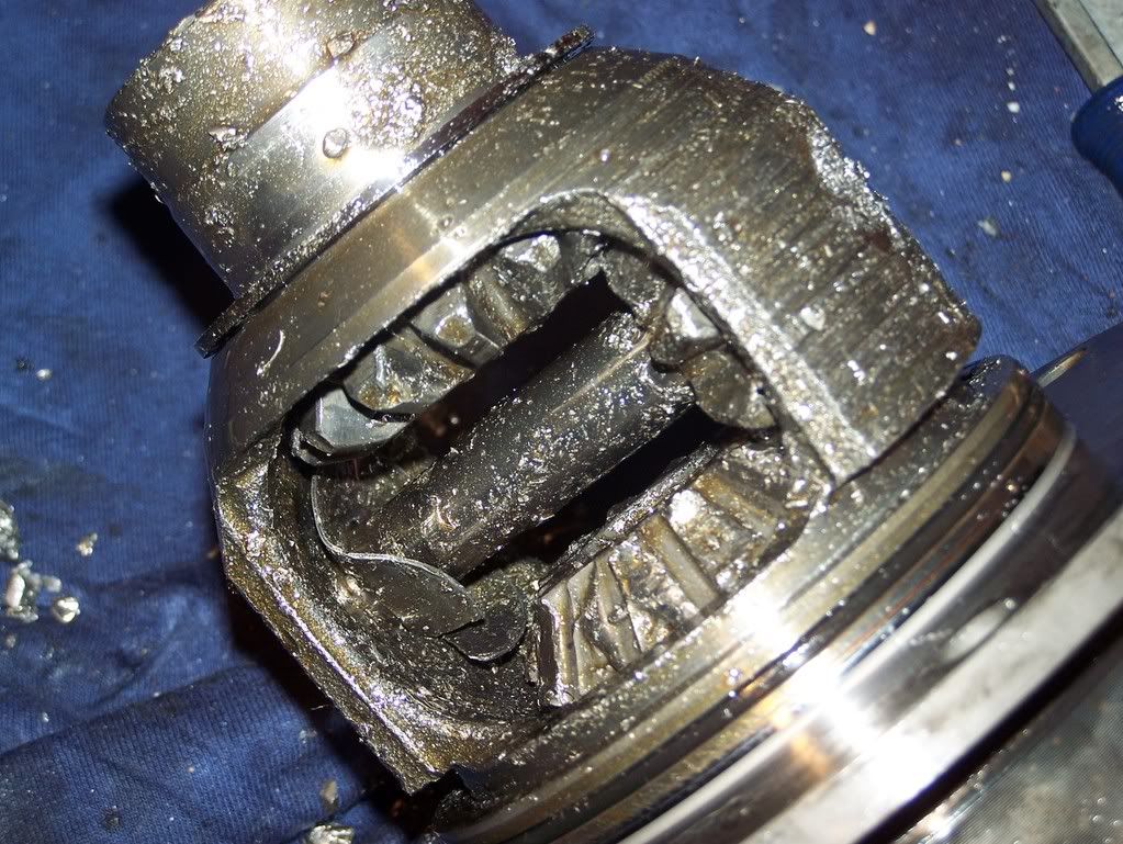

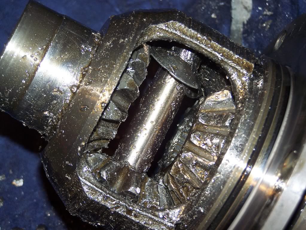

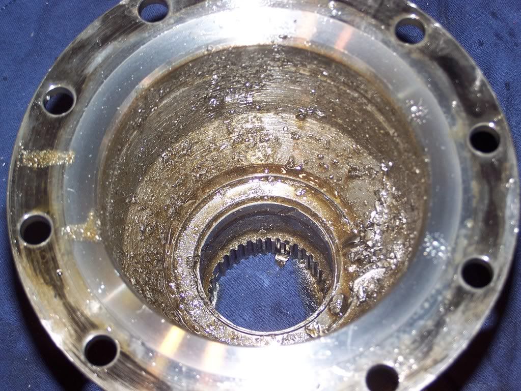

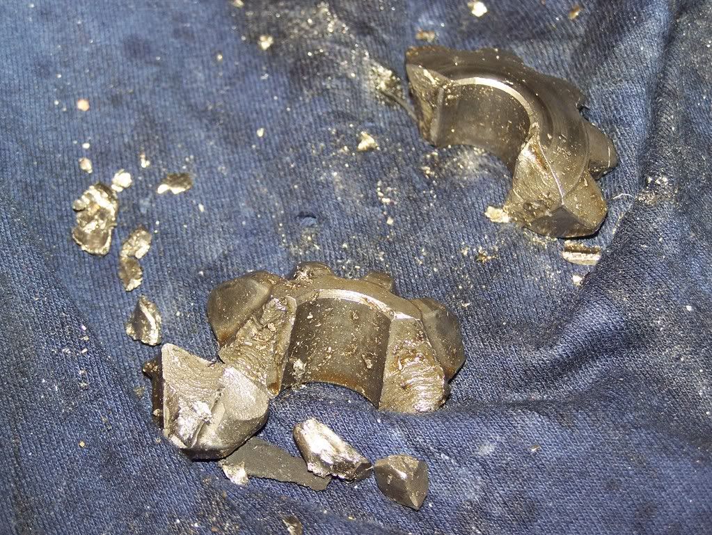

Here are the carnage pics...

wtf did you do!?!?! launch your car at 150000 rpms??

I honestly don't know what happened, on New years eve I accidentally stalled it( not paying attention to what I was doing, then when I got back to the house it and everyonce in awhile it would pop and u could sorta feel the wheel skip or hesitate. so I had to get it back to VA Beach, from gloucester county. which prob didn't help the situation and then left it at my brother in laws house till we were able to work on it. I had taken it to the dealership to have them look at it they did and sid that it was something in the transfer case. well no s*&t sherlock and they gave me a quote to fix it and it would have cost 2800- 5000 dollars. that is when I promptly picked up my car and we just pulled it ourselves. so now I am going to ship it to Shep transmissions and have them do a rebuild. so how it happened exactly I don't know.

geez louize....total carnage.haha. Now this is what the front diff? i see the 2 pinion gears and side gears?
it was the front diff.

That is what happens to those weak 03-04 GSR transfer cases when they break.The other problem with them is ring and pinion wearing out prematurely doe to improper shimming(causing the severe whine)
