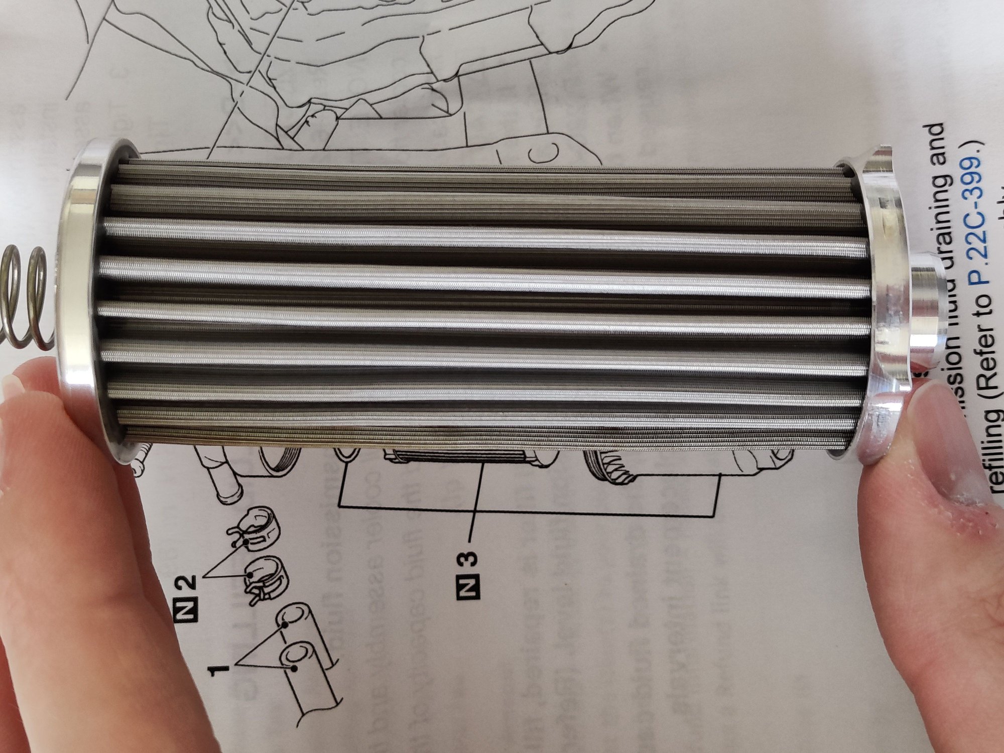

My filter arrived, but i am a bit concerned about quality.
Is this normal? I thought the "burnt" area could be a weld of the mesh, but it seems a bit strange and protuding.
Anyone had experience with this filter?

I would agree with your assumption that it's where the mesh was secured.

It is where the mesh is secure.
FWIW, I wouldn't bother with this. You can get an OEM filter with the oring for $35 from Kozmic and replace as needed. Stainless filters can wear and reduce their filtering ability over time. And cleaning them ****ing sucks.
I had one in my SST. Lasted fine over 120,000mi. Changed the fluid 3 times, each time the filter ran black when I soaked/cleaned it (it cleaned a lot better with an overnight soak than it did just trying to spray it out) but I'm not convinced it did as good a job as the OEM filter based on how BLACK the first one was at 30k mi.
And yeah, when I first got the car the filter was over $50 from Mitsubishi and hard to get.
