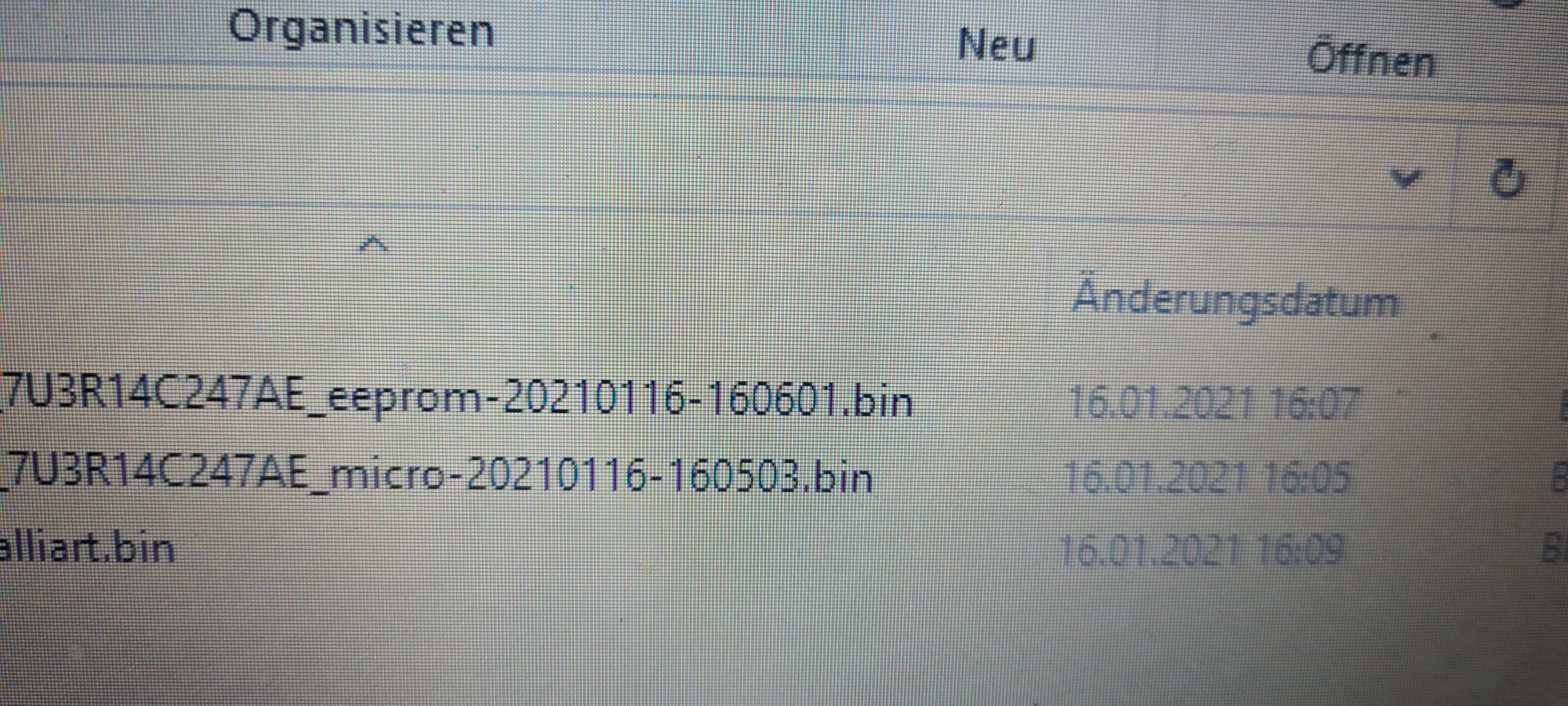

Hi,
yesterday i read two bin files from the SST direkt over CANBUS. One is Eeprom one is Micro.
The Micro have 1.5MB. File Name is 7U3R14C247AE.bin
Eeprom have 8KB and its a binary file to.
I take a look inside the Micro file with Winols. There are Maps inside.
Some infos i found in the file.
EVODOMR03 8631A827
EVOEUR03 8631A827
EVONASR03 8631A827
8631A379
at the End of the most Maps i found
CANC_3I_SEVERINS_21012005.dbc
Does anyone can Help with this Informations? In a few hours i can Upload the Micro file.
Some Updates:
Yesterday i take a look into the Eeprom file. I found the Number from the Binary file 7U3R14C247AE, the Nr. 8631A827 and 8631A379, the VIN and EVOEUR03.
The Car is a EDM Ralliart. I think the Eeprom says the Car is EDM and Load the EVOEUR03 selection from the Micro into the RAM.
The Eeprom file is for cloning i think.
regards Dom
