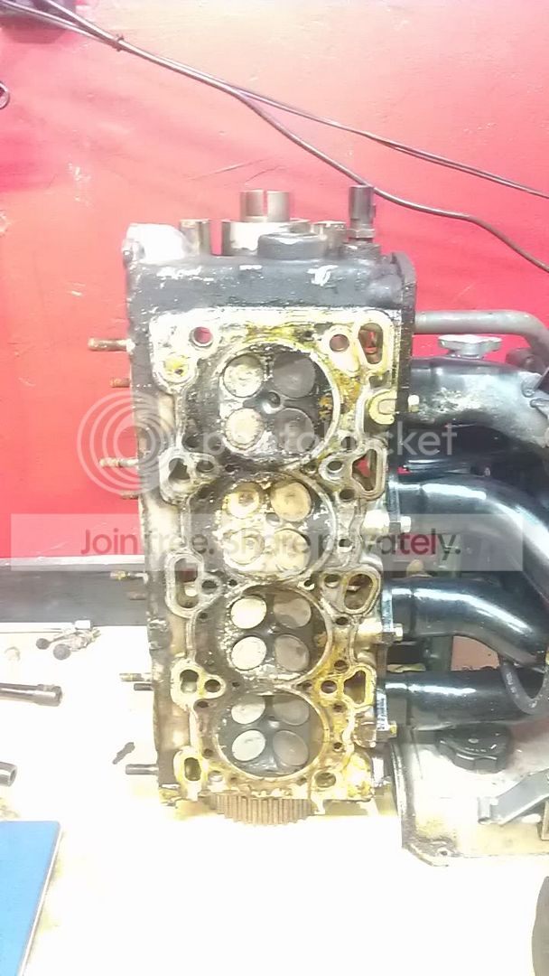

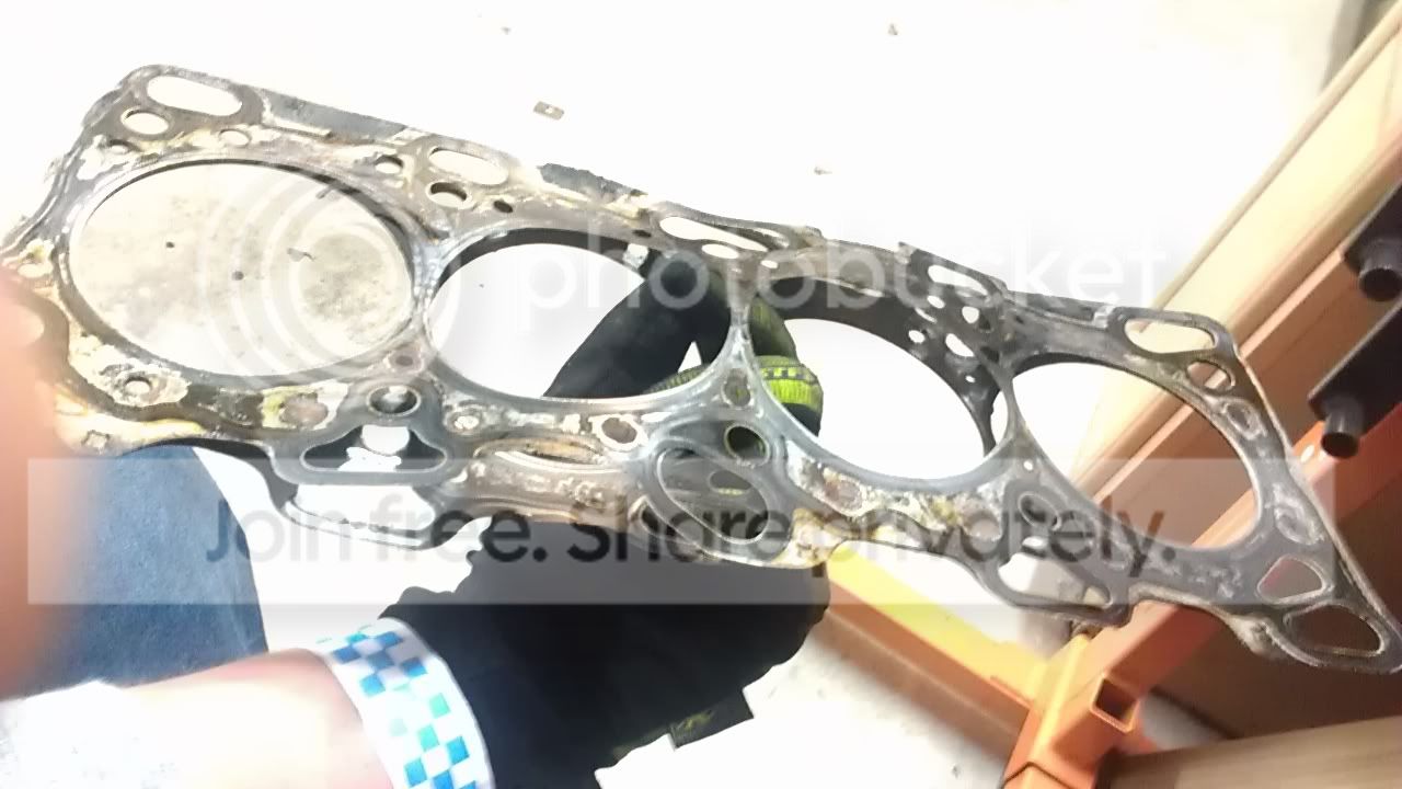

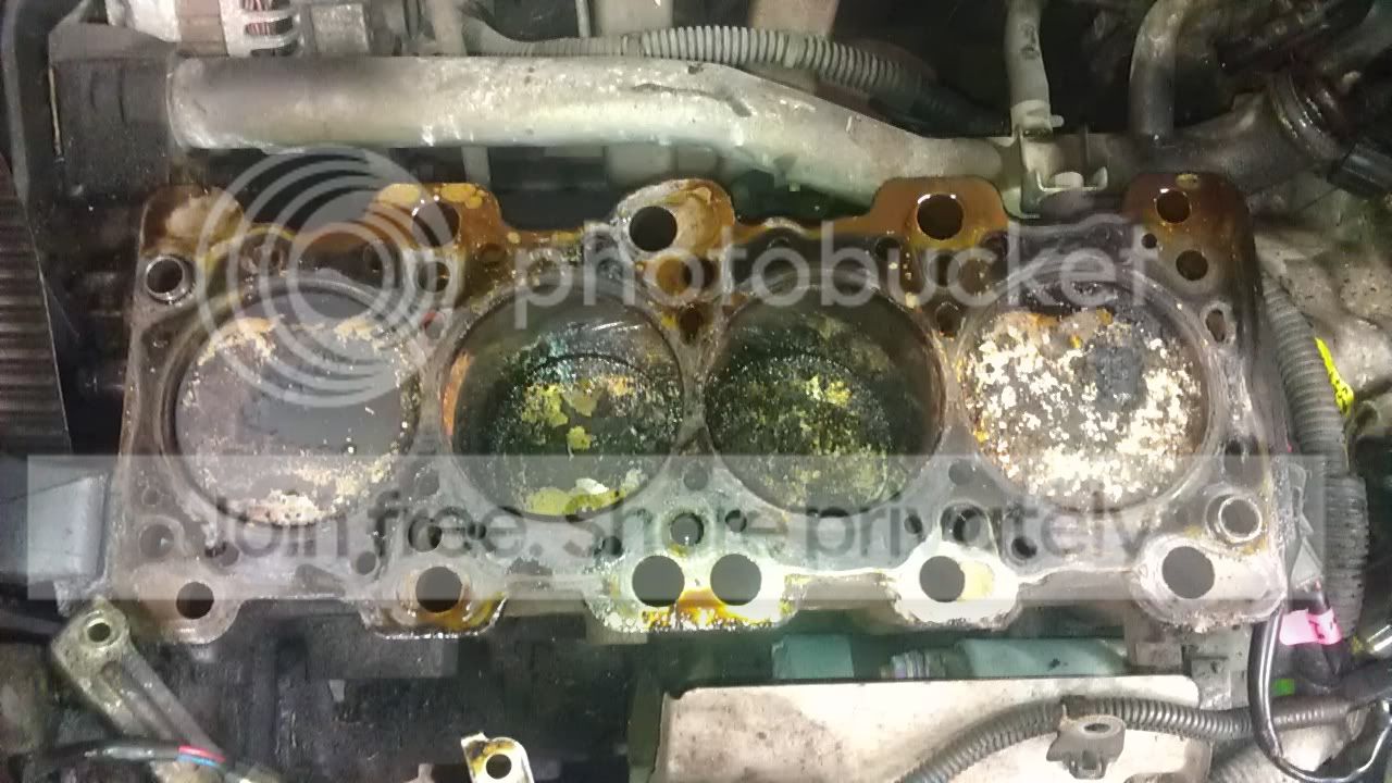

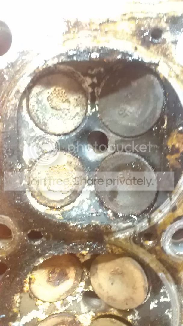

Split Headgasket
Block and Pistons.
Valves... :/
Head
Im hoping someone can give me some hope because to me this looks pretty bad. I put the engine at TDC and I still cant get any of the rocker arms to move, Im going to try turning the cam tonight and see if its just really tight for some reason, maybe check the valve lash. And those pistons look pretty ugly too. And overall the whole engine is covered in oil and the water pipe seems to have some type of gunk or corrosion in it. So im starting to doubt the reliability of this engine even if I do replace the head gasket now... :/ Maybe Im just over thinking it and it will be fine if I clean it up. IDK. Thoughts?
Split Headgasket
Block and Pistons.
Valves... :/
Head
you should maybe have the head and block decked before replacing the gasket...if you want to just sell it, I would say clean it the best you can, and put 'er back together...
