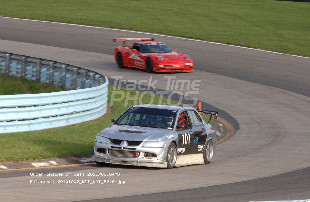

Charlie North (Function First Motorsports) has built and set the suspension on my NASA Super Touring Evo 8. It corners flat with out lifting the inside rear tire. Moton Club Sports are used with Charlies custom made aluminum suspension bushings and mounts. Yes, suspension travel is key. Instead of lowering the car onto the suspension Charlie built custom side skirts to lower the body and retained stock suspension height. Spring rates, weights, and specs are top secret. The car is very light up front with Charlies custom aluminum motor mounts and removal and relocation of the wiring harness.
A lot also has to how you enter a corner under braking. I can horse the steering and make the car understeer or be smooth in setting the car into the corner and rotate it by lifting off throttle.

^^^ i remember seeing that Evo at WGI that day. i know the guy in the red C5 behind you
