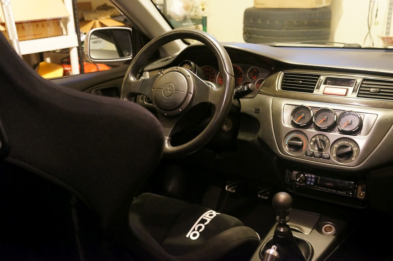

I also finally switched the radio and the gauges. With the radio up top, it was hard to see in sunlight. Also, with the gauges at the bottom, and the Autometer pod protruding a bit from the console, it was easy to sort of punch the gauges while shifting into 1st, 3rd and 5th. Here's the new setup - I like it a lot better:
