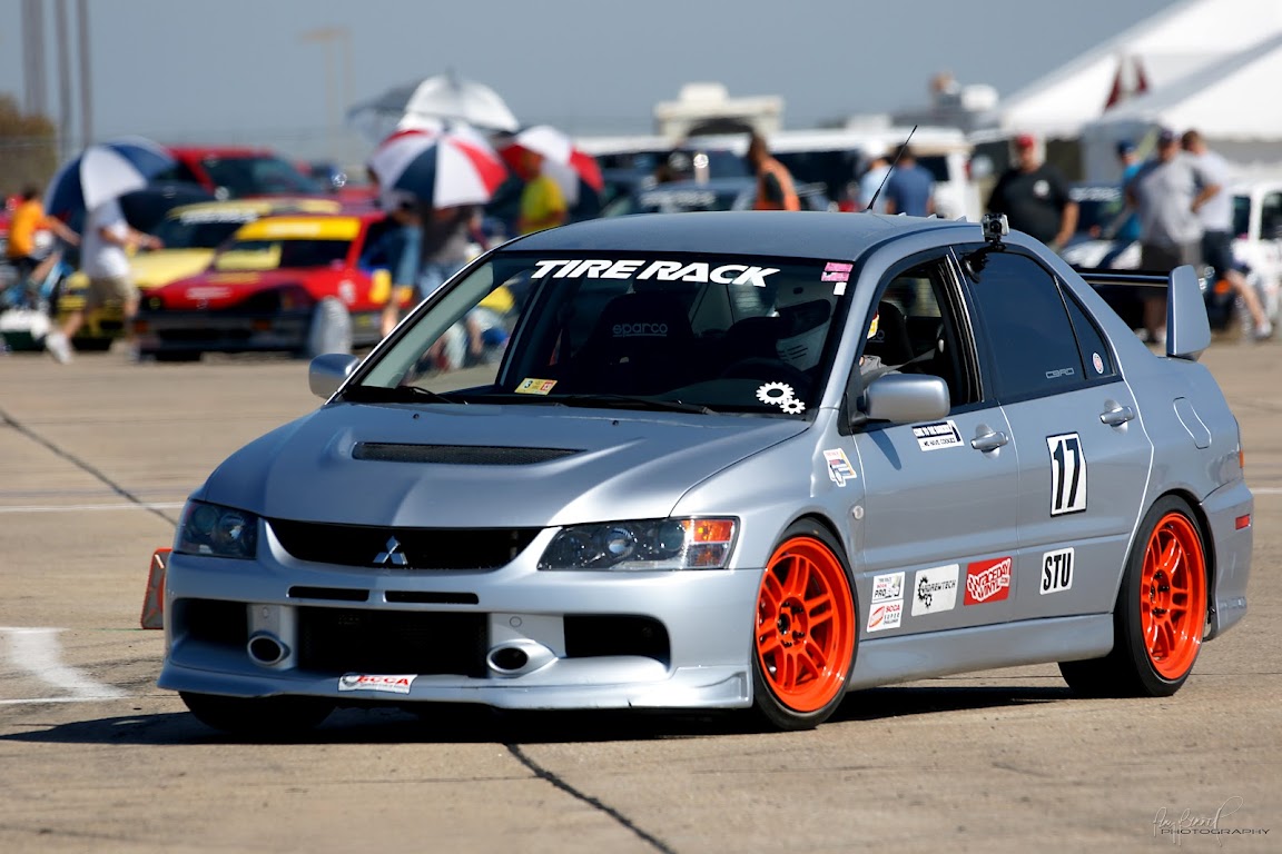

Finally got around to pulling all the pics off my camera and pulling other people's pics off facespace. Here are some of the other ones I liked:
