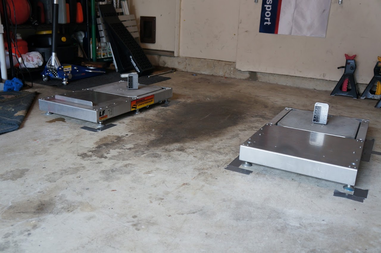

Getting the car on some scales
I last weighed my car in ~April 2011. It was 3172 at the time with about 1/8 a tank of gas, coilovers, stock BBS with RE11s, and a battery that was heavier than stock. I've read all the STU threads and remember some of the folks with RS's getting into the 29xx's. I wasn't willing to go without ABS, which ruled out the RS. My #1 option would have been an SE, as the aluminum roof *and* ABS. But SE's are hard to find, so I ended up with an MR "SE" (MR+appearance package). Near as I can figure, the MR-SE is an SE but with the Bilsteins, the vortex generators, and the 6-speed. From what I've read (might even be linked in here someplace) the 6-speed is about 15 lbs heavier than the 5-speed. If I was ever concerned with weight, I could do a stock-legal package conversion of the car to become an SE - swap the 5 speed, remove the VG’s, switch badges, and have everything else. I’m not likely to do this unless the 6-speed dies but it’s something in the back of my mind.
Now that the suspension’s back on the car, I wanted to take a crack at weighing it and possibly corner balancing it before getting it aligned. The goal was not to be a total slave to the corner weights, since it’s an Evo and it’ll never be balanced “right”, but just to see if I could get it to not be terribly off. I managed to find a friend willing to let me borrow his scales for a little while. I figured I’d document this for anyone reading this in internet land who wants to give this a go themselves. The following caveat applies: I have no idea what I’m doing and you should not impersonate this because awful things could happen. I did the best I could do based on the research I did, but I had never done this before and make no claims about accuracy. If you have suggestions, please offer them. I am capable of learning
One really obvious one is that I don’t have adjustable endlinks. From what I’ve read, on EvoM and elsewhere, in that case you should just leave the endlinks connected.
https://www.evolutionm.net/forums/ev...k-endlink.html
Some other links I found really helpful:
Corner balance guide in general, from Longacre
http://www.longacreracing.com/articles/art.asp?ARTID=1
Rob’s S2000 corner balance
http://robrobinette.com/corner_weight.htm
A thread on LotusTalk about DIY corner balancing. This one was incredibly useful since it was pretty much the same equipment I borrowed:
http://www.lotustalk.com/forums/f91/...ustment-77759/
That equipment was all from Longacre:
* 4 scales
* 4 leveling pads
* The main number box thing
* A “laser” leveling set (not the magic auto-leveling kind but still plenty useful)
* A stand to put the number box on so it was easier to see from the driver’s seat
The overall flow:
* Get the car race-prepped - fuel level, basic guess at ride height, same wheels you race on, etc
* Mark roughly where the wheels are on your floor with tape.
* Get your car out of the way so that you can do the leveling (otherwise the car will block the “laser”)
* Set up the “laser” on its level surface.
* Using the “laser”, set up the leveling pads and make them level.
* Plug stuff in, make sure everything works, and zero out the scales.
* Move the scales out of the way. Move the car in.
* Lift the car onto the pads, and roll it onto the scales.
* Jiggle the car a bunch of times to get as much of the bind as possible out of the suspension.
* Measure. Check weights.
* If you need to adjust, roll the car back off the scales to the back part of the pad, make the adjustment, and then roll the car forward and do the jiggle again.

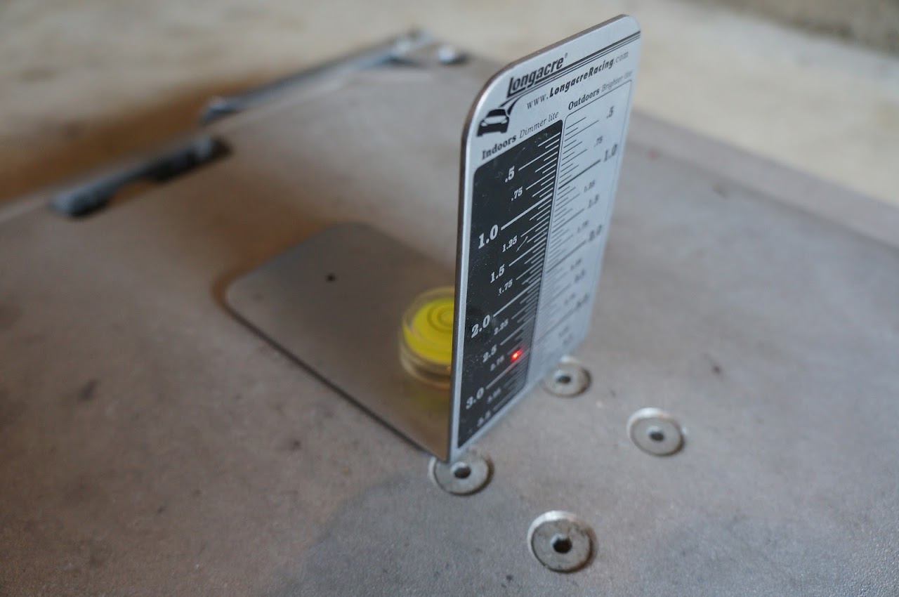

The first thing I did was set up the “laser”. It took me a couple minutes to figure out, but the easiest way seems to be to align it on the two-post side first
… and then adjust the one-post side until it’s level in every direction.
Longacre does make one of these that automatically levels itself, if you are in the market for this sort of thing. One mistake I made was that it wasn’t in the middle of the 4 pads - I didn’t see that in the instructions until afterwards. Still, it was level (according to the bubble) everywhere so that should be okay.

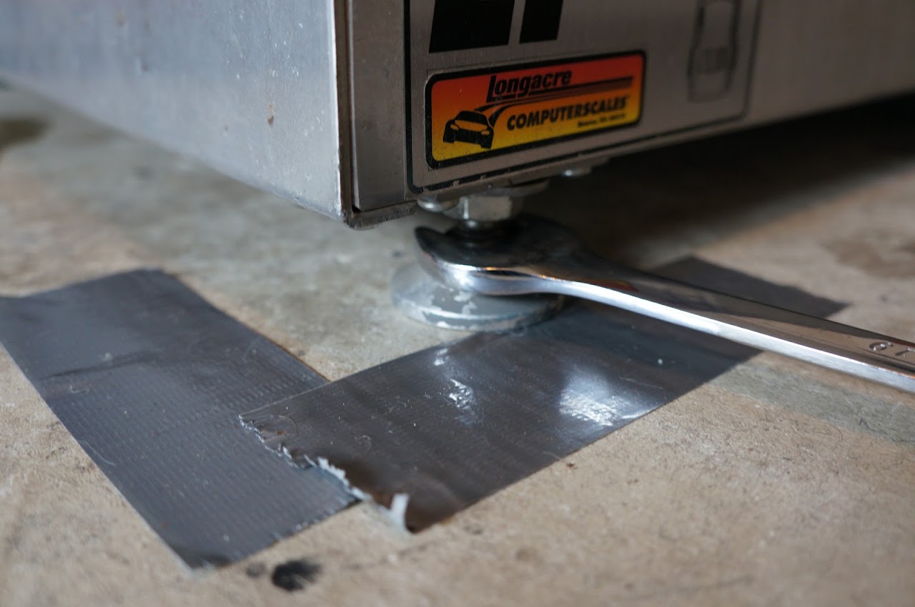

The next step, and by far the most work, was to create a level surface with the pads. The laser level kit comes with four of these:
You put them on the scales (making sure that the feet never go into the 4 indents) and then aim the “laser” at a certain height. Then you go around to each of the 4 leveling pads, raising and lowering it as necessary in order to get all 4 on the same level.
The garage is sloped a bit in my townhouse. I didn’t realize how bad it was until doing this. I had gotten 3 of the pads fully level and all at the same height and was feeling good. Then I got to the front left and realized that the slope of my garage was so bad that I needed to almost start over. See, the rear right pad looked like this when it was level:
Note the difference between the front side and the back side. The back screw was pretty much at the end of its adjustment range. Meanwhile, the front pads were pretty much at the OTHER end of their adjustment range.
So I needed to pick a common height that would work for both sets of pads. This involved a lot of tweaking and cursing but I eventually ended up at 2 and ⅞” all around.
After getting the heights set, I tightened the locking nuts
And then hooked up the scales in order to zero them out. I hopped on each pad individually and they all weighed me at either 170 or 171 (wearing a very heavy sweatshirt
) After that, I slid the pads out of the way to pull the car in.

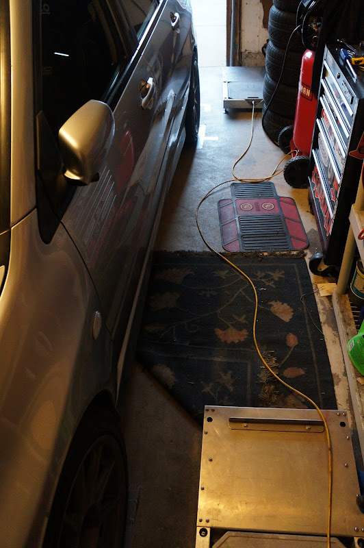

You have to be somewhat agile to work in a 1 car garage with all this stuff in it. There is not a lot of room on the sides.
Then put the car up on the pads, one scale at a time.

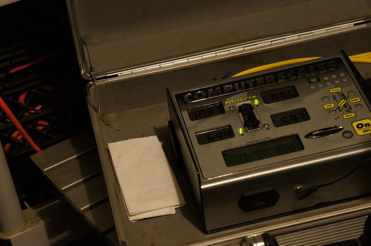

I had my first weight! 3113 lbs. For clarity, this is with the fuel light having just come in (about a mile ago), my normal stuff in the center console, no floormats, and the TRM wheels instead of the lighter SSR Type C RS’s. Then I realized I should have switched wheels while the car was still on the ground. Doh!

) After that, I slid the pads out of the way to pull the car in.You have to be somewhat agile to work in a 1 car garage with all this stuff in it. There is not a lot of room on the sides.
OK, after clearing out the center console and putting the SSR’s on, I was down to 3085 total (LF: 951 ; RF: 980 ; LR: 594 ; RR: 561) and a cross weight percentage of 51%. Not bad for eyeballing the heights. Then I remembered I hadn’t jiggled the car yet. Shaking/bouncing the car didn’t change the weight (as you’d expect) but it did change the percentages:
.3% better with just shoving the car a bunch? Not bad!
Then I remembered that the car wouldn’t be very effective for autocross without a driver. So I hopped in the seat to see how bad it was with me at the wheel. The total went to 3259. And the cross percentage went to 50.5%. I hopped out, flipped out the driver’s side mirror (I folded it in so I could get more left in the garage), jiggled/bounced the suspension again, and got back in the driver’s seat. I ended up with this:
50.3%. It would fluctuate to 50.4% if I held my arm out the window, so I decided to call this good enough rather than try to chase down those last three tenths and risk making it worse.
All that setup just to find out that the corner weights were good enough already. Ah well, it was still pretty interesting.
