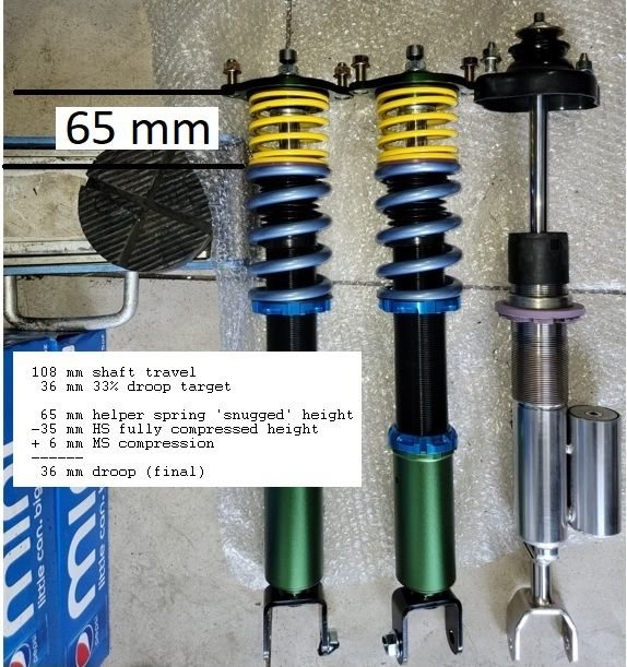

I think there's only 225lbs on each rear spring. the rest of the weight is below the spring. my 900lbs springs are compressed ~1/4"
You are right that not everything is on that spring, but 1/4" looks a bit on the lower side. Regardless of that, more of the issue is in the front where we have much more weight and ration is close to 1:1. Even if you take out 200 lb of weight there, you still have 700 to 800 lb left. Suspension will move at least 1.5" (if not even more on street tires) during driving, so potential of binding is there. Basically, we just need to be aware of it and make sure it doesn't affect things.

I was at 7" with helpers/couplers but I won't be able to fit 285s with that setup. The Eibachs are maybe not as good as Hypercoil/Swift in this regard (how much travel they have before bind) but it's still pretty good. Per Sam @ Stranoparts "The block height of the 700 Eibach is 2.87". So 3.13" of travel total. 3100# car, 60/40, so ~930 lbs on each corner (** roughly!) so the spring is compressed something like 1.4" at rest, leaving roughly 1.7" before bind?
Those numbers are pretty low already for 7" springs. 6" would probably be just over 2" of allowed travel and that is awfully close for comfort. It sucks that you can't fit 285s with them, though...

I measured (MS in the pics)

my spring compressed ~6mm or 1/4". 1/4 of 900lbs/in is 225lbs. I think a lot factors can make a difference. I maybe 1 mm off, or my rake was not exact when jacked up from the control arms. the angle of the control arms also (my car is high).

I think I should have put the jack to lift right on the hub face somehow. that should be accurate. I doubt I'll get ~1" compression tho.

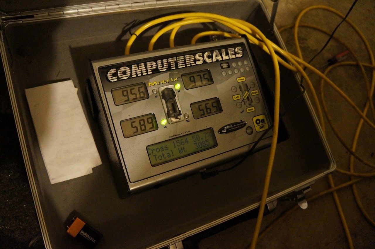

FWIW, my car from like 2013. Wheel/tire package is heavier and I have a regular-old Autozone battery now and an FMIC so it's certainly a bit higher and frontheavier.
