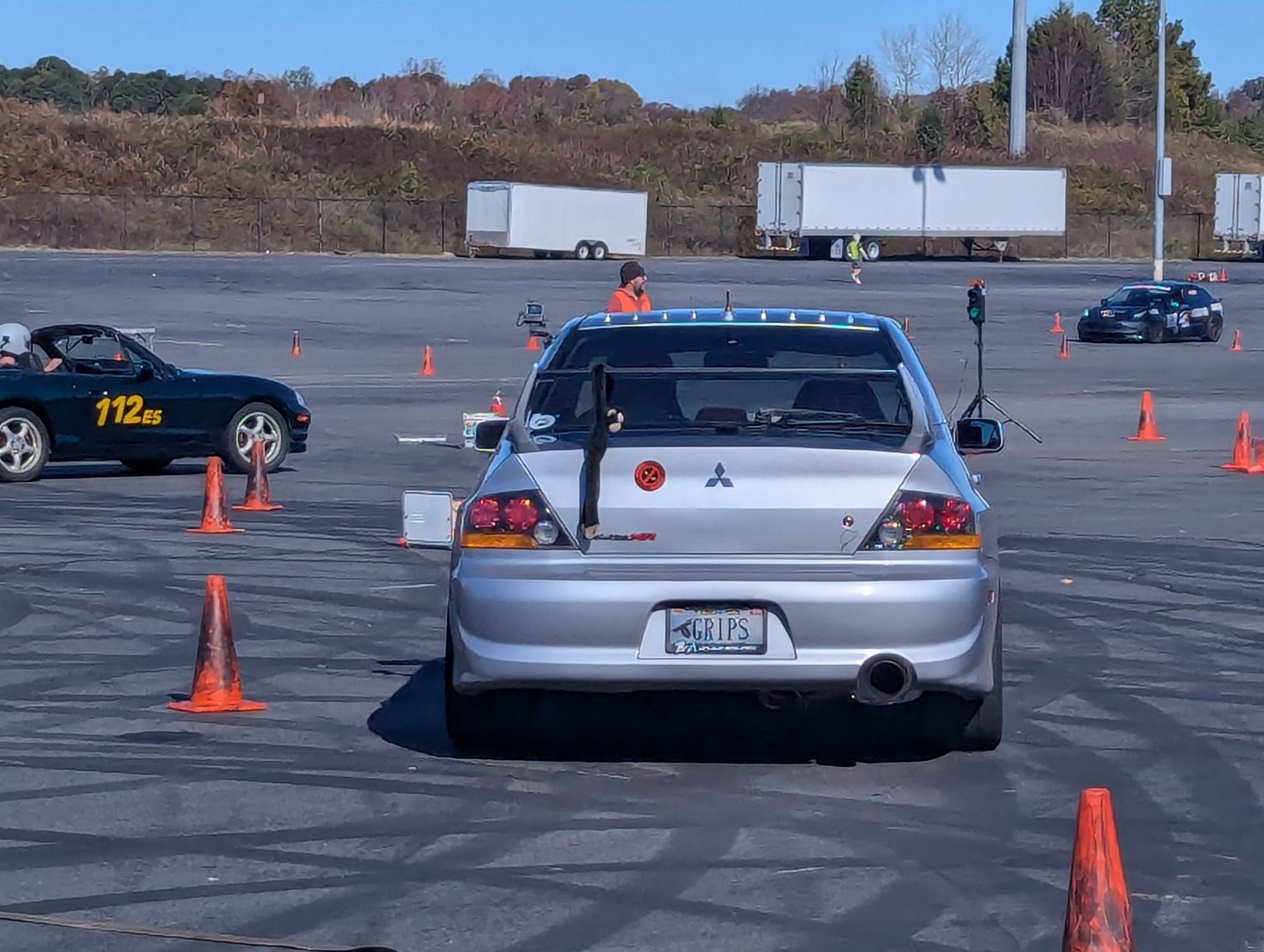

2024-11-16: CCR SCCA @ zMax
At KOTM, I mentioned to Josh that I really needed to get down to zMax someday after hearing about what a good site it was. Josh mentioned that there was a year end event there around November and that he’d be happy to codrive. I have not actually had a codriver at an event since 2013. The primary reason is that my schedule has been volatile and I don’t want to strand anyone without a drive if I have to cancel last minute.
So I had totally forgotten how to codrive with someone. It is a different game in a lot of respects, some good, some bad.
Good: someone to look at video with, give you feedback on driving, feedback on setup, general camaraderie type stuff.
Bad: a lot less time between runs, easier to make the tires too hot, occasionally you drive really dumb and feel slightly bad
This was a two day event with combined times, with money going towards Racing for Heroes ( https://racingforheroes.org/ ). I ran pro w/ Josh expecting to not do that great. I signed up for the event pretty early, but then I had to go to Europe for work:
... which meant driving from DC to NC, flying from NC to DUB, and then flying back to NC Friday night before the event. One cool feature of the event - they had two Mustangs on street tires for folks to pay $ to take charity runs in, with a standalone shootout for just the Mustangs based on how fast people were. You pay for your runs, they feed you into the queue and you go out and hoon.
Reply 0
Apr 5, 2025 | 03:30 PM
  #650
Day 1
Day 1 was a mess. Josh took to the car pretty quickly and he also started the event with two reruns (downed cones) so he had lots of opportunities to get acquainted with the car. But there were some sections where we were riding the rev limiter for a second or two and the car did NOT like it. I had this experience before, but it was really bad at this event. You get on the rev limiter for a second or two, because shifting to third would not be worth it, then you brake and get back on the gas for the next element, but the car stumbles really badly and makes you feel for a second like the engine is gone before it comes back.
https://www.evolutionm.net/forums/mo...l#post11980541
Quote:
yes, fouled plugs. I figured out that the boost control strategy I was using was causing boost to go up on the rev limiter (like up to 28psi instead of the normal 14psi on stock turbo) and get into spots on the fuel map that were not tuned well and dumping lots of fuel.
This issue is something that’s at the top of my prep list for 2025. The original CBRD tunes dealt with this situation gracefully but the current tune is not. It’s not something I specifically mentioned to CBRD, or to the current tuner, but they must just have different defaults I guess (also CBRD had a lot of autocrossers going there). Riding the rev limiter in 2nd is not a common thing tuners have to deal with, so it’s in no way a knock on the current tune which is totally fine in every other scenario.
This was really debilitating; it was happening more than once per run sometimes. You can kind of drive around it by feathering the gas once you get to the top of the rev range but that is A Thing You Have To Think About which takes away bandwidth for things like looking ahead and braking correctly. One possible thing we could have done was bump the limiter - I’m at 7800 currently so only a mild bump from stock. But for a local event that was just supposed to be one fun event to finish out the year I didn’t want to do that.
Since it was a local we did ridealongs the first couple of runs. Since Josh had run first, I had already seen him drive once (maybe twice, with the rerun, I forget) and so I went out on run 1 mega poorly calibrated, basically asking the car to do things that were not physically possible, crazy overdriving. It’s one of those things, I don’t think this would happen at a normal event where I was solo driving, but sitting in the passenger seat I think can mess up your idea of what normal is (everything seems to feel faster in the passenger seat). Josh was like “dude, what are you doing” (from a place of love). I was definitely on the struggle bus. The car felt fine balance wise - it was a transition heavy course, very runway style. We could have loosened it up a little bit but figured that the gains in the lower speed stuff might get canceled out by having the car want to kill us in the higher speed stuff.
On top of the stumble issue we hit a CEL at some point after Josh’s 3rd run. I googled it - P0500 - it didn’t seem like something that was indicative of something critical to the engine, tune, etc.
https://www.evolutionm.net/forums/ev...re-sensor.html
So I cleared it with my trusty code reader and we kept going (#yolo). But there was a 5 minute period there where we were talking about possibly borrowing a trailer and towing the car back to VA with Josh’s Jeep.
I’m glad we didn’t, but it gives you a sense of my mindset. I was driving badly, the car was misbehaving in multiple mechanical ways that I couldn’t address and I wasn’t learning anything either because it was really hard to just focus on driving. And all of this, after working around the logistics of going to Ireland in the same week. I was pretty mentally defeated.

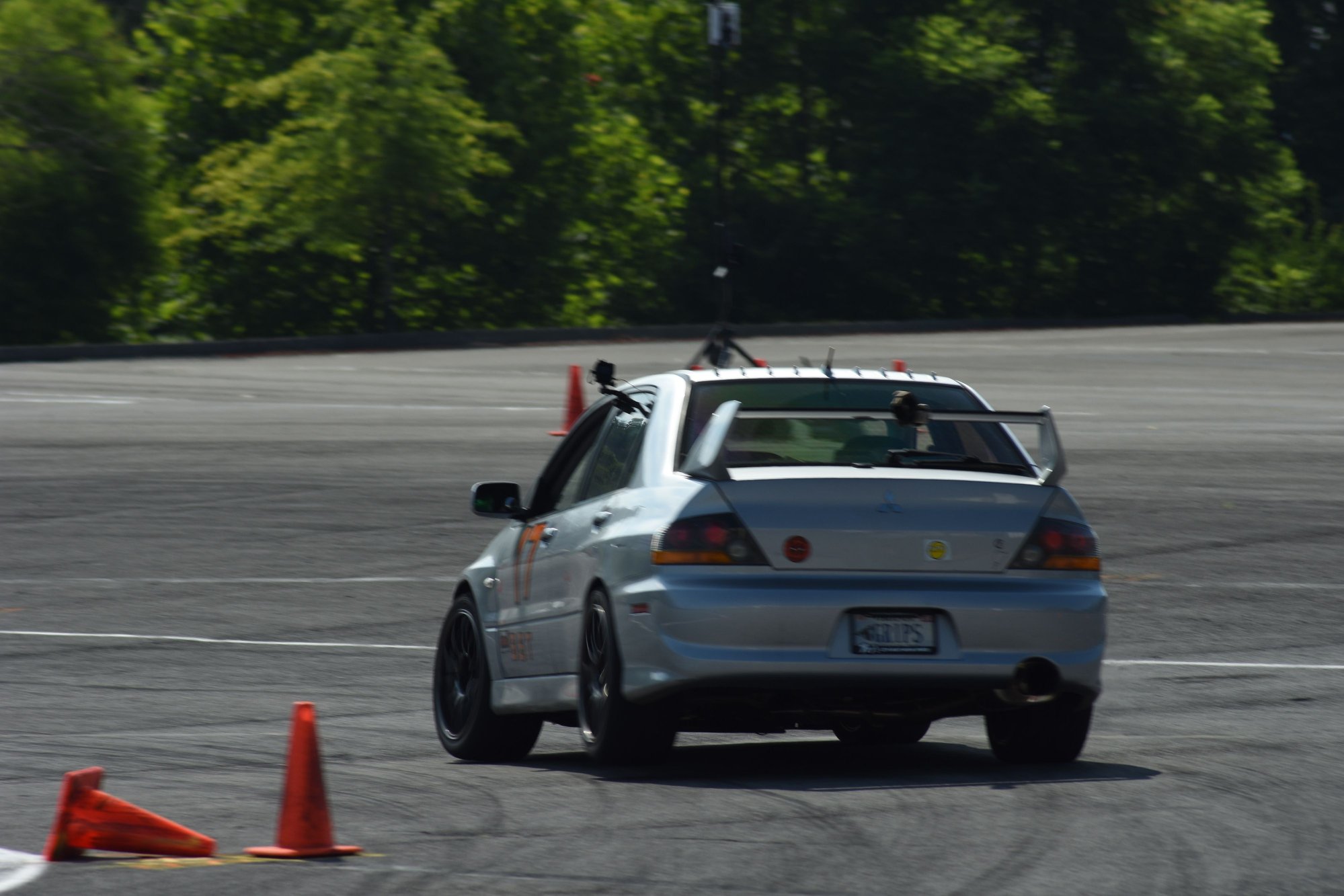

2025-07-04: Bristol National Tour
I got in on Friday and was reminded by my knees how much driving this car for 6 hours isn’t fun. The drive to Bristol is pretty brain dead though, 66 W, 81 S, you’re there. After taking way too many course walks (to make up for my poor looking ahead) I packed it in for Saturday.
I legit could not remember my last tire pressures for the Yokos. I think I was running something like 29/28 or 28/28 but I don’t actually keep notes outside this thread (I should probably start). I started with my normal 2/3 F 3/4 R shock settings and went from there.
Run 1 was surprisingly fine. I ran a clean 56.530. Myke D ran a 56.101 and was 4 tenths up. As I got more comfortable I found more raw pace on run 2, 55.714 +1, and ran a similar run 3, 55.862 +1. Myke ended up sitting on his 56.1. So this was a reasonably good sign, sort of; I had the two fastest raw times in class, and despite coning runs 2 + 3, I was only four tenths out and not totally hosed for day 2, pretty reasonable damage control.
All that said, even my fastest raw time of 55.7 was still more than a second off Will T in AST who ran a 54.694. So I have a lot of work to do, for sure. AST is a slightly faster class on PAX but only slightly.
