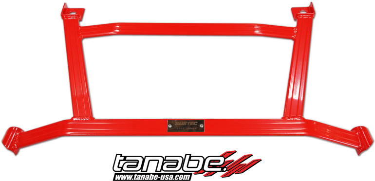

Ok, swaybar decision seems to be relatively easy on which one I should do if I decide to go through the trouble of upgrading. Next up is underbody body and chassis bracing. Since I've been running skid plates under the car for years, I seem to have lost those two black bars that tie the control arm mounting points together. My car is relatively stiff...fully seam welded and rally cage that ties in at 10+ points around the chassis.
I don't have the money or desire to bolt a jungle gym to the bottom of the car with the whole line of Cusco bits, but since I don't have those OEM braces, is there any benefit to picking up a brace to tie the front and back edges of the control arms together? Seems like there are two styles, a plain jane looking box, or the Tanabe which ties into the upper bolt on the control arm.
Now that I think about it, the Tanabe option might be better as I think those tabs on the bottom of the front edge of the control arm got bent up pretty good. Rears are still fine, but somehow I unwelded the captive nuts on them...quick instal FTL!
Another brace that I see folks mention as being beneficial is the front fender brace. Seems like there are two styles to these:
Seems to me like the fully triangulated one would do a better job, but it sits pretty close to the fender liners, so I'm wondering if that might cause issues with wide tires and a lowered car.
