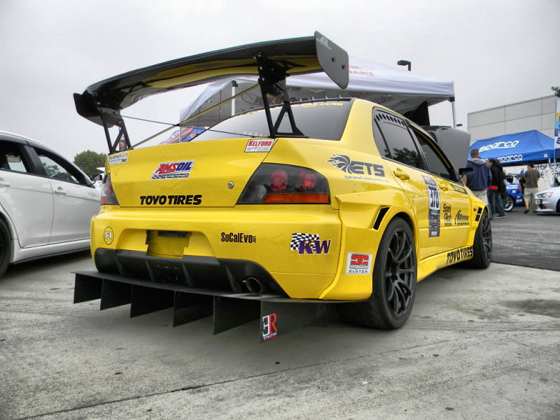

Here's the custom diffuser I bought for my car (diffuser pictured is mine, the car is not)

Who makes that, and where did you get it?
Exactly the style I was looking for.

there is A LOT to take into account if your trying to build an actually effective/functional diffuser. the one posted above looks pretty decent. one issue is that with how low the pare tire tub sits its tough to get a good enough ramp angle.

any chance to can share some more details on ur diffuser? need to build one for my car and your's looks perfect for my needs

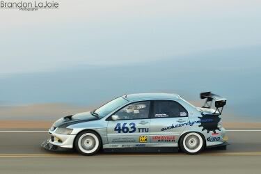

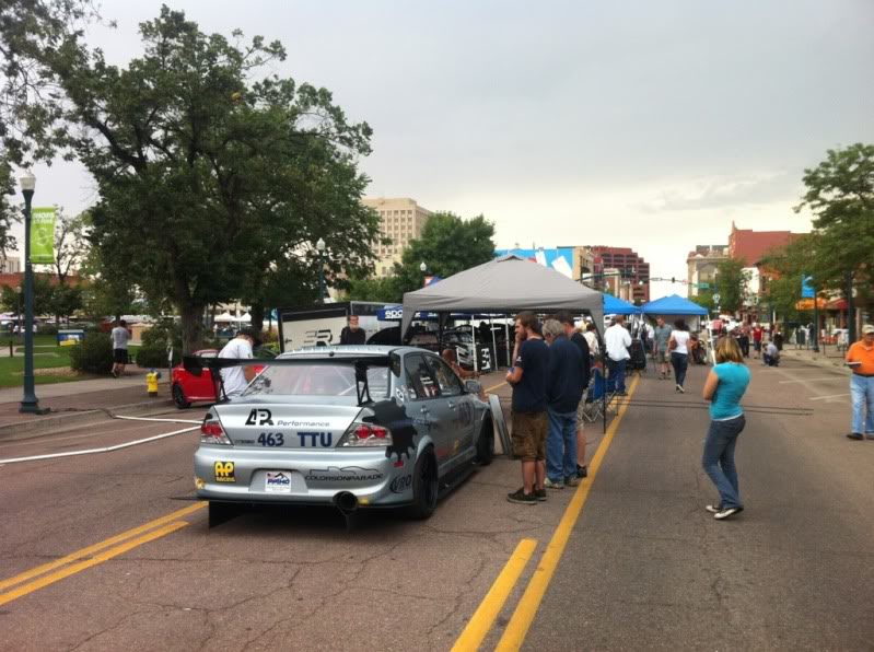

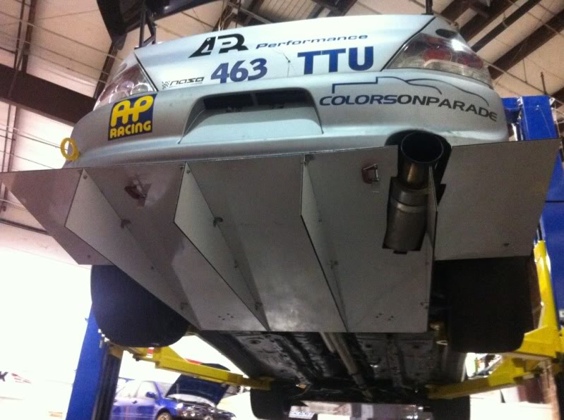

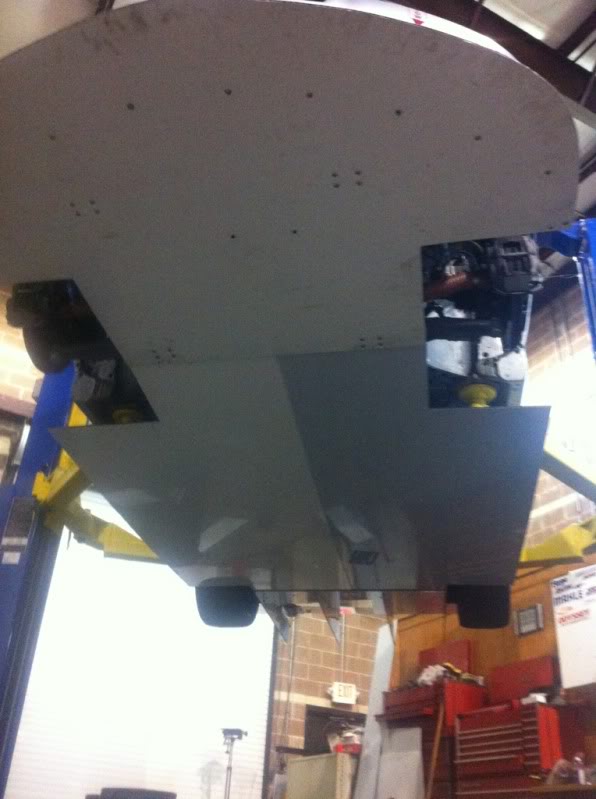

Made mine with alumalite. Took 4 sheets to do the entire bottom of the car, and a lot of thinking to make it all easy to take off and get on the trailer.
I didn't have a spare tire well but I did have the fuel cell in that position. It was at 10 deg which was exactly the slope of the rear bumper. I think it was 42" long for the strakes.

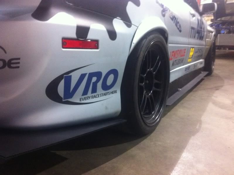

It was 2.5" of ground clearance from front to back.
