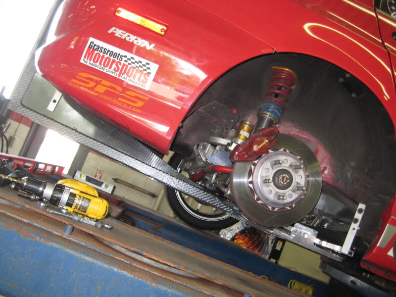

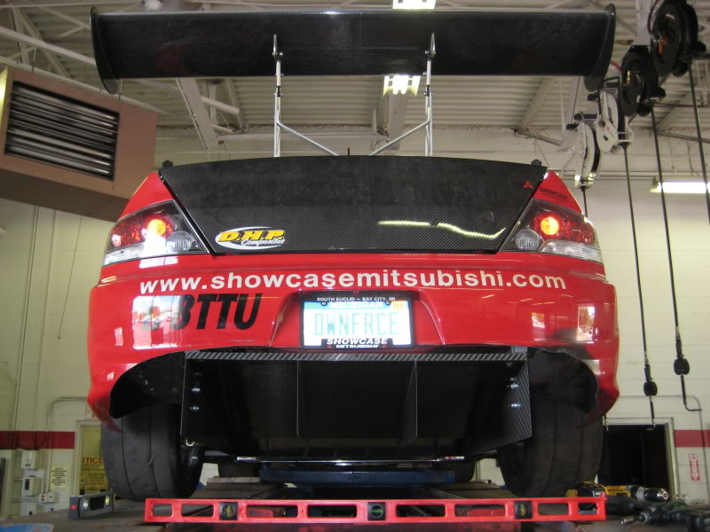

Some pics of the initial mock up. . .

I didn't even think to talk to DHP about a rear diffuser.
If you don't mind posting it, what was the cost on that?
You can PM me if you don't want to post it.
