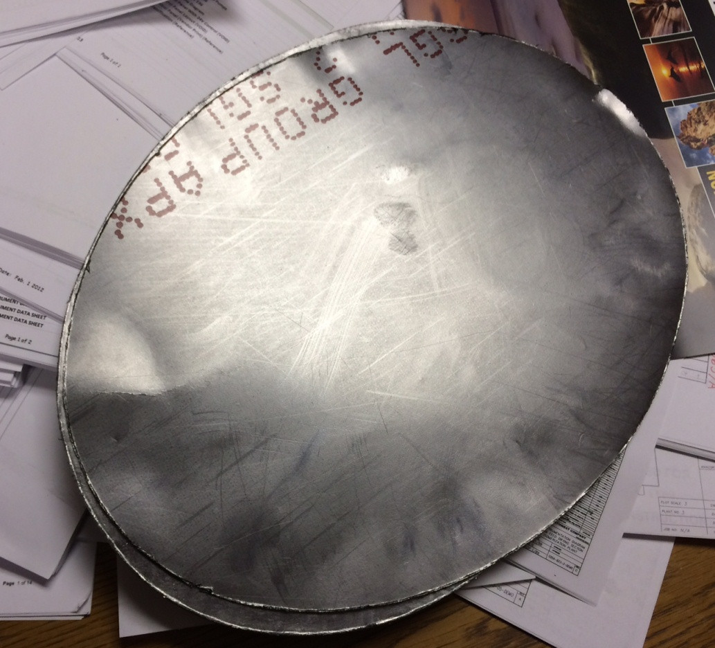

Welp. Got my carbon graphite gasket material. The gasket rep recommended I use the existing SS sheet metal gasket and sandwich it between a sheet of the carbon graphite on each side. He was a little concerned about oxidation so I will have to keep an eye on it.

That gasket never blows. I'd tighten the bolts a bit tighter and safety wire them, but I don't know if I've ever seen any come loose.
