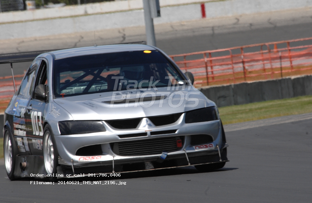

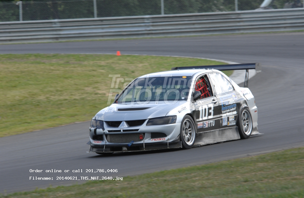

Picture from Sundays race at Thompson Speedway.
