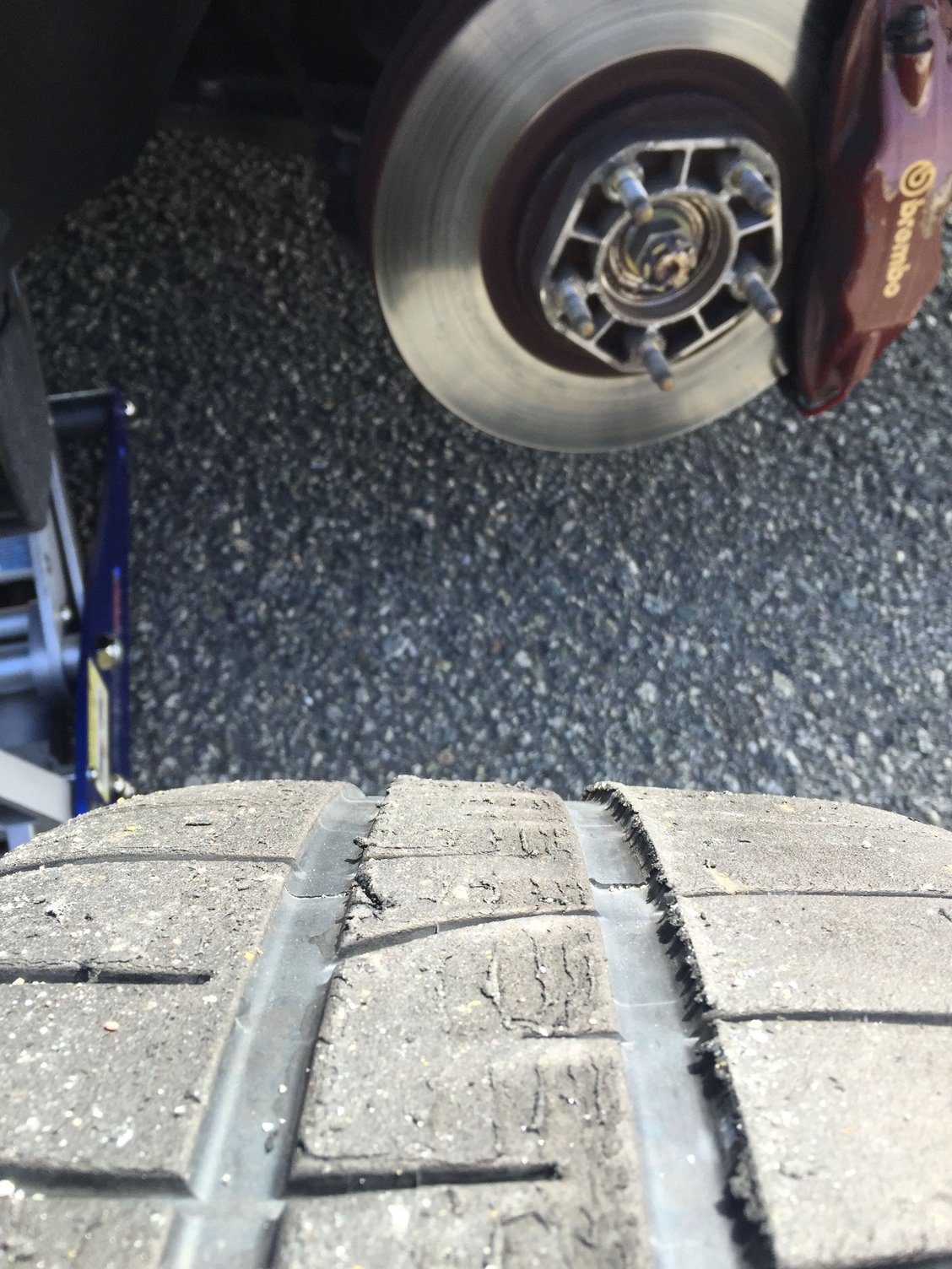

Some pics of the front tire wear. Also, the rears picked up a fair amount of OPR at a site that doesn't normally have that issue. It seems like the center block is tapering toward the outside, and has already tapered down to the wear bar.
That's the right front, and the course was counterclockwise and very heavy on left-hand turns. I'm really hoping that these tires are a little more durable than the 10 runs we put on them appear to show. We may need to play around with the pressures some too. We just kind of threw a guess at it that seemed to work. It's also worthwhile to note that the car is probably pretty undersprung, so once we take care of that, hopefully we'll see better results.

I have no specific experience with the Rival S tires, but the Dunlops (until the release of the RE71R) had been the class of the field in longitudinal grip. I struggled a bit with the original Rivals, especially under braking as the lack of straight line grip would upset the ABS until I got brake pads with less initial bite. It had never been an issue on the Dunlops.
The OPR may actually be graining on your tires, rather than pickup. I got a bunch of that on my RE71Rs as well, the newer tire compounds are pretty soft, and supposedly benefit from a heat cycle before driving aggressively on them else you get that tearing of the surface of the rubber.
Also, with the original Rivals wore through the first 4/32 or so of tread really quickly. They stayed at 2-3/32 for significantly longer and the grip didn't really drop off until they corded.

Thanks for your insights, Bryan
I think during our first few runs, Rich and I were still getting used to the lack of longitudinal grip (compared to the Dunlops) in terms of braking, but we realized that we didn't have to slow down as much on the Rival S because they had so much more lateral grip, so we could carry more speed into turns. Pretty worthwhile tradeoff in my opinion
