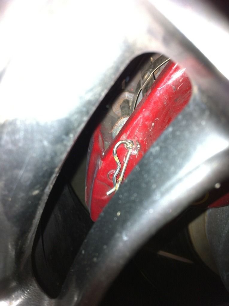

Had to go digging waaay back to find the pic but here it is:
(fixed)
Not an issue ever since. Clips are from the $1.00 kit at harbor freight. Grind half of the end flat then use a drill press. The rear caliper pins are not fitted nearly as well as the fronts, so that heat (as you got faster) expanded the caliper (flex) and creates just enough gap for the lead to slide out.
