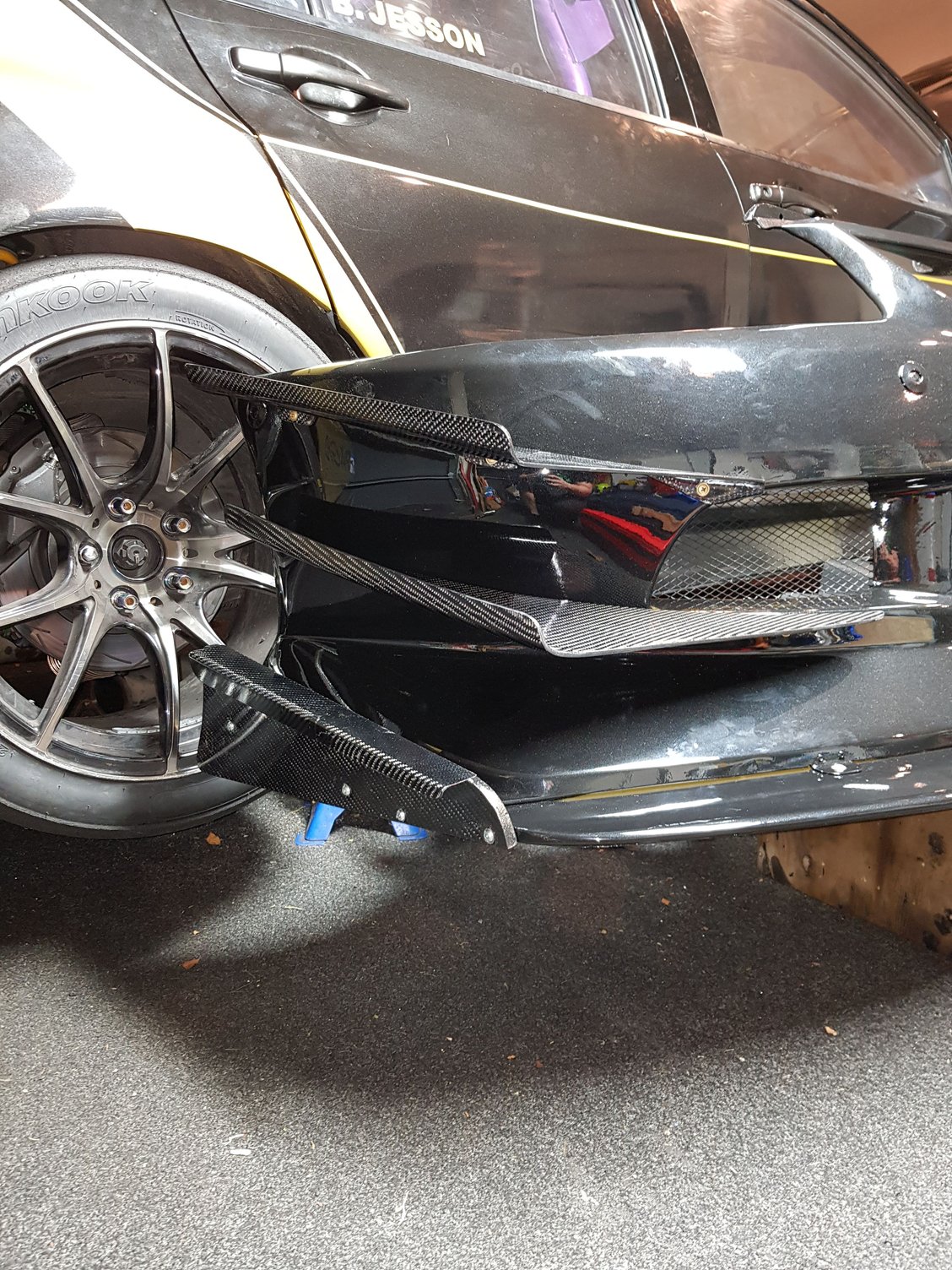

So weve got a new version of our Voltex front bumper to try this coming weekend.
note the lowest canard/endplate on the splitter and the little end drake weve added. Weve noticed this on quite a few high end time attack cars recently. We think the theory behind it is to try smoothen the vortices over the wheel.

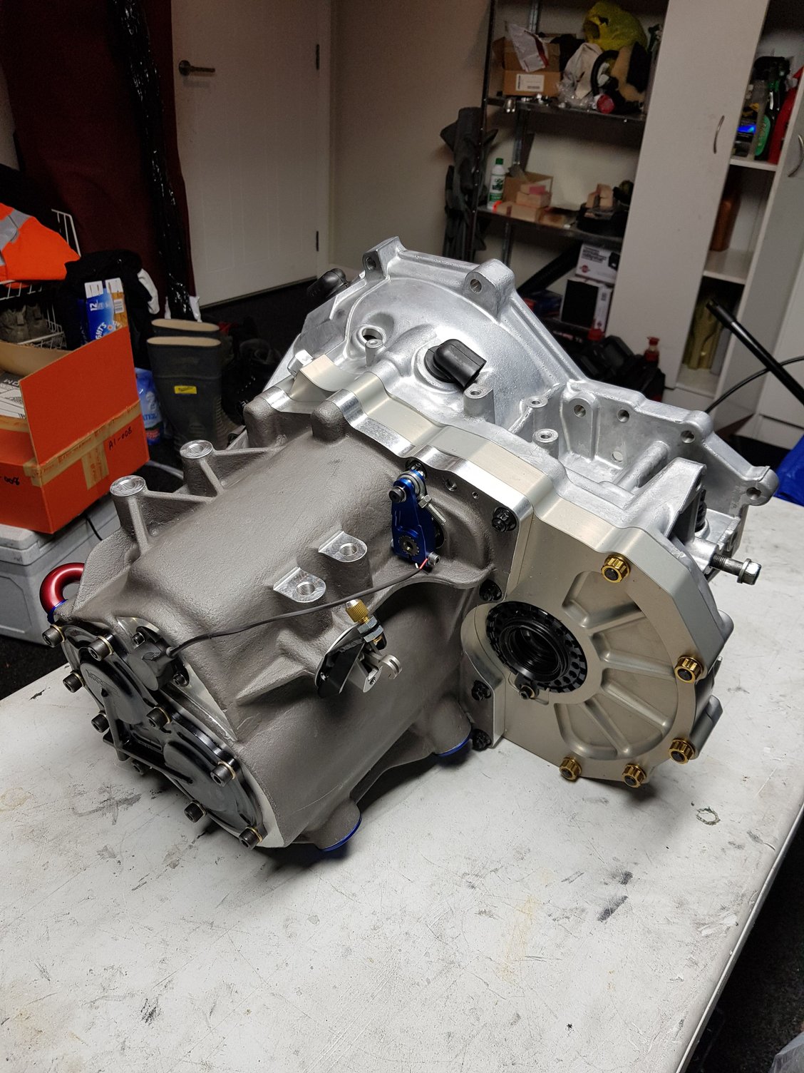

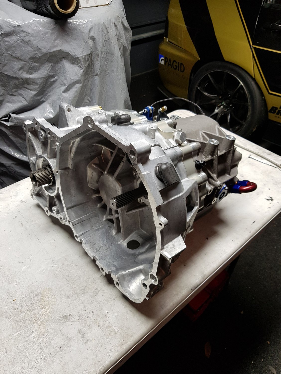

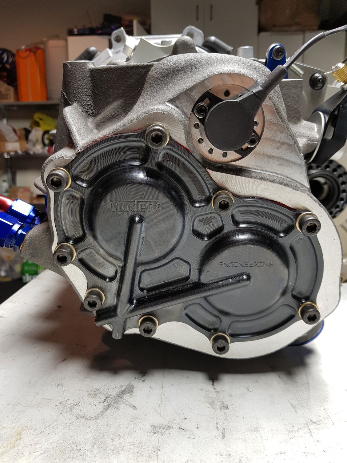

Modena Sequential is installed!
Hey All. Bit of an update. We recieved the Modena Engineering Sequential gearbox around 2 weeks ago. have installed it over the past week and had to make up a custom shifter linkage pushrod. We have fabricated up a temporary shifter mount out of stainless but we aim to replace this very soon with a billet aluminium cnc'd piece.
Couple photos of the sequential for a bit of car part **** for u all. Will update with some photos of it all installed shortly once i get the new shifter mount and its all looking pretty! Cant wait to drive it in the next week or 2!
Its a beautiful piece of kit. Brand new bellhousing also
One interesting thing to note was we had to cut a small section of the chassis rail out where the seam is spot welded together in order to install the box. Will have to tig the cut out up. the new housing is slightly longer. and we had to space out the cusco gearbox mount as it was hitting on the casing.
