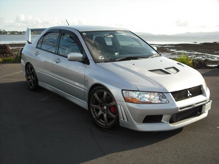

Hey All. (post 1 contains info and pics of the car as a street weapon, post 2 is the motorsport evolution)
Not sure where to start with this thread. Please bear with me. i will compress 9 years as much as i can into 1 post! Ill also do a mega photo dump at the end. Feel free to save or use any of the photos for private use. if you wish to use them anywhere publicly please credit either my instagram and facebook or the photographer that has been watermarked. Ill endeavour to keep this updated as we continue to modify! Starting With the installation of our Modena Sequential gearbox!
Also feel free to float over to my instagram and facebook and flick me a like or a follow:
Instagram: https://www.instagram.com/jessonmotorsport
Facebook:
https://www.facebook.com/JMSEvo
I guess ill start from the beginning, This will probably end up super long so bear with me, hope u all like reading! Hopefully my experiences and mistakes can be of use to some of you in the future.
Hopefully this also provides some of you with inspiration to carry on with your builds!
So where to begin,
I purchased my Evo as a near standard immaculate Japanese import here in new zealand in may 2009. It had 107,000km on the clock, Some 18" Advanti vortec wheels, Tein super street adjustable suspension, HKS SSQV BOV, Walbro intank fuel pump and and evo 8 rear spoiler. Was retuned to 200kw ATW on stock ECU.
Pretty perfect street car really!
Unfortunately 1 week after buying the car i decided to give it a birthday with mobil 1 full synthetic 5w40 oil as recommended from factory. Immediately after doing the oil change the engine began to make the all too familiar nugga nugga of a spun big end bearing. I never figured out if the previous owner had noticed the bearing and masked it with very thick oil (it was like glue coming out when drained) or wether it was just bad luck.

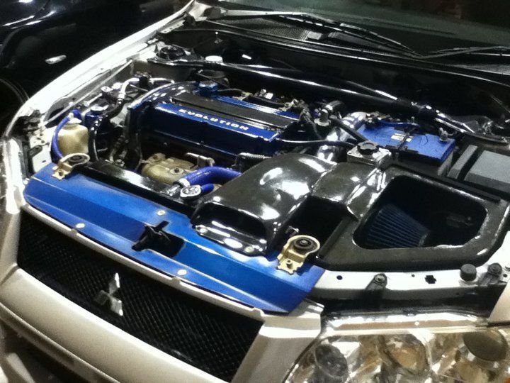

This is where the fun began, We purchased a standard evo 7 engine block and installed it into the car so i had a car to drive and i begun researching the best ways to build an evo engine. After hours of research mainly on this forum and lancer register.com i settled on building a 2.3L stroker engine (bearing in mind this was 2009 and nobody had really developed a 2.2 or 2.4l engine yet!) I set about sourcing the best parts and settled on JE 2.3l Pistons and eagle rods and crank.
I am fortunate enough to have a fiercely supportive Dad with extensive motorsport knowledge so we begun about preparing the new block to be converted to 2.3l
We begun by doing a massive porting and flowing of the intake and exhaust chambers, We then slapped the block together and threw in a set of kelford 272 cams to match. Also had a wicked pair of kicker 12" subs and dual custom amp install!
We finally got around to installing the new 2.3l block ourselves. We added a link G4 plug n play ECU and sent it off for a tune! 220kw ATW. This was big power for an evo in new zealand back in 2009 which netted us our first national magazine feature!
The modifying bug had well and truely stuck and we continued to steadily modify the vehicle. Eventually Adding a Garrett GT3582R turbo and sinco turbo manifold along with a long list of other modifications.
Fast forward a few years and i begun using the car in car shows competitively and drag racing. making a healthy 350kw at the wheels at this stage and a best quarter mile time of 11.4 ( i was never very good at drag racing)
I begun to focus on modifying the exterior of the car next. I added on a pair of Rexpeed side skirt extensions and evo 9 front and rear bumpers. then followed the evo 9 hood and on and on from there as u can see in the pictures.
Nice Evo, makes me want to put my Kognition design spoiler back on my Evo 9.
