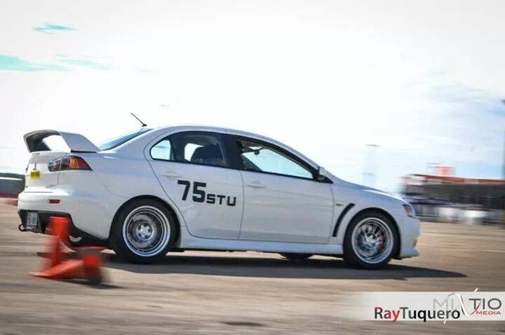

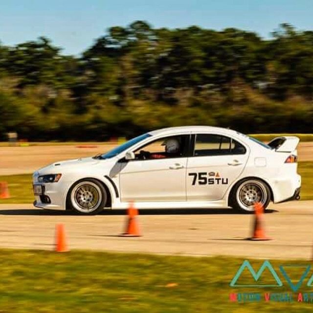

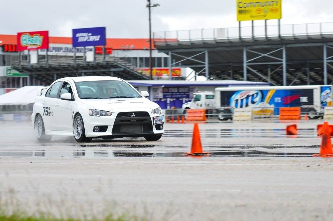

Intro
Hi guys. Really late to the party. Quick intro. 75 Stu is a 6x Houston region class champ. Tuned by Kozmic (to old Stu boost restrictions) custom valves ohlins, mongrel exhaust made out of various bits, 265 tires on 9.5s. Looking for advice from anyone who has fitted 10.5 enkeis on offsets as I am looking at stretching the tires for a bit more responsiveness. I liked the way the car handled better on stretched 245s than the square 265s on the 9.5 nt03s. The new nt03 03rr in 10.5 in 25 offset I is tempting

My NT03's were 18x10.5 +30. Did not have to roll fenders with 265 RE71r's. I did use a 15mm spacer up front to widen the front track width. This is with -4 deg up front and -2.5 in the rear. Car was very fast this way.
