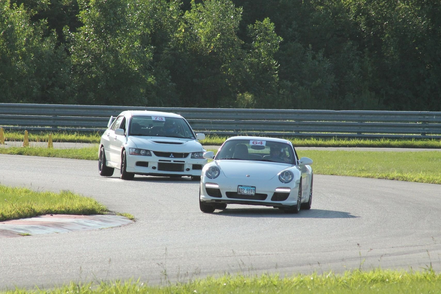

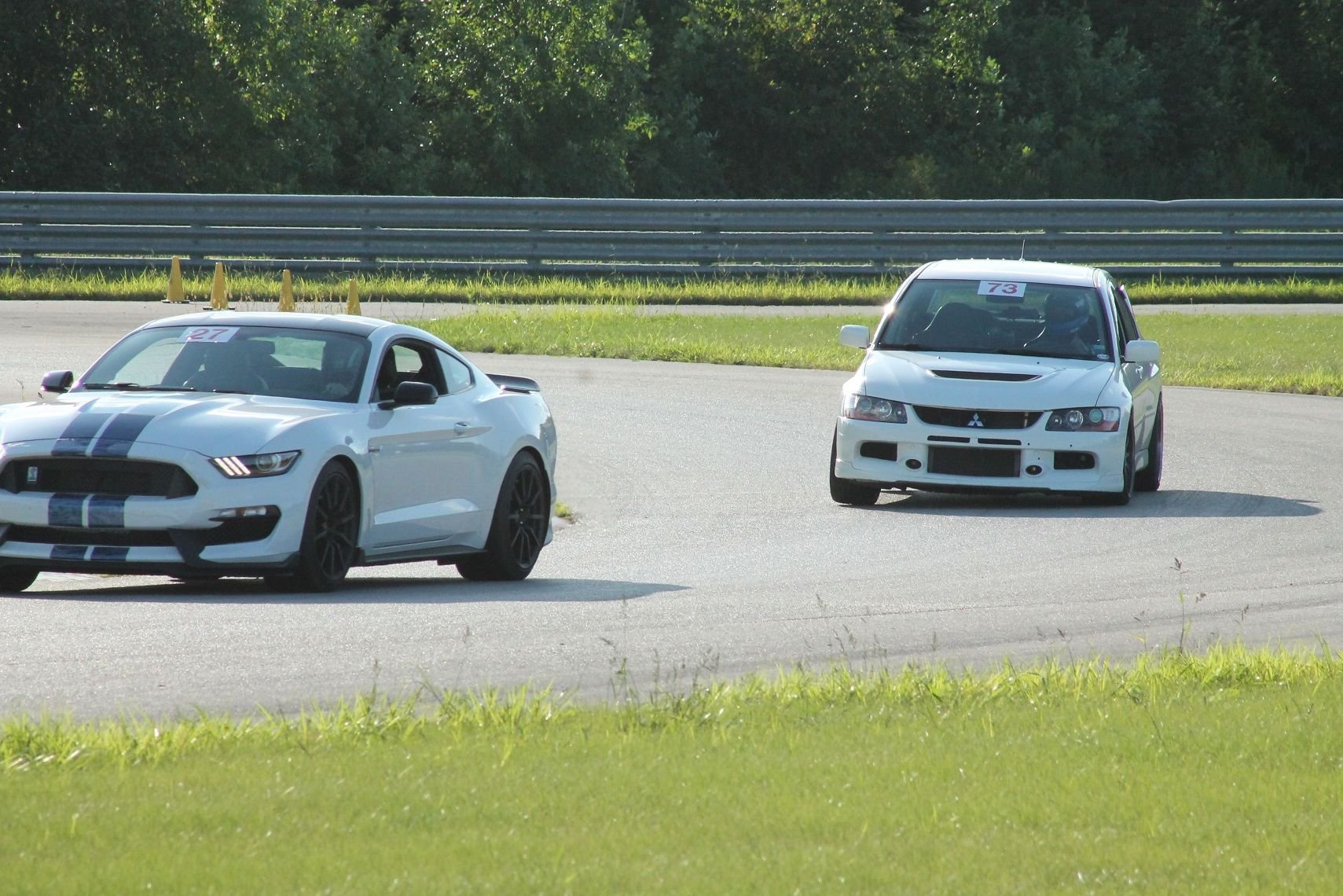

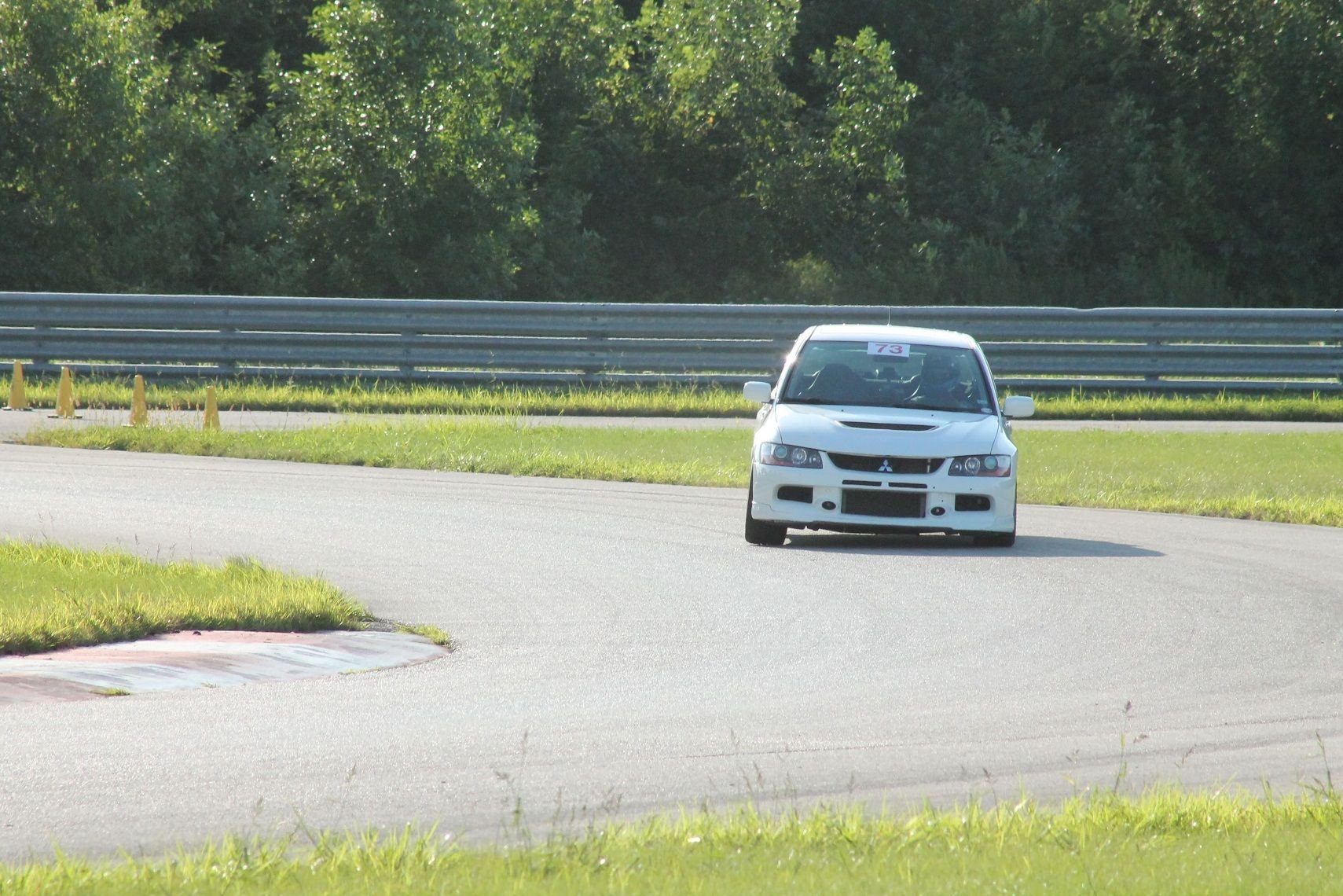

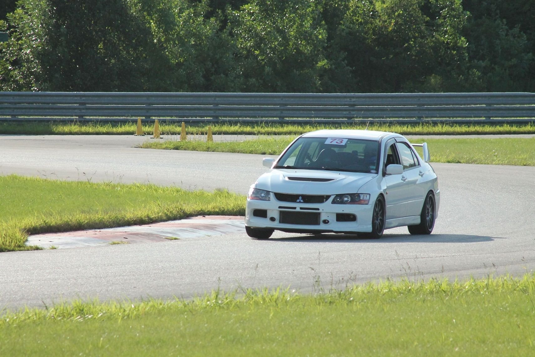

on the rears, mine will be around 1" of compression (11k springs, cb'd & rears are about 600lbs both sides). I'm the one that's been saying let the rear lift, and others have been saying to keep it down! for god knows whatever reason.
I was thinking specifically on the fronts too though, when it's loaded up on one side, from the pics you can see the edges get some air in the front. may help there too, but how do you decide on
1) assist vs helper (per swift's website)
2) what rate to get?

I wouldnt run them up front. If you are properly loading the outside rear, the inside front will keep loaded also. No reason to carry that extra weight up front.
11k rear, i wouldnt run any tender/helper/assist spring. If you were around 16k and cared about street manors then yeah it would be ok. Im more than double your rear rates and I feel the assist is only working against me in getting the inside rear up.
I'll tell you, even big bad wolf (S2000 that destroyed SSM this year) purposely lifts the inside rear.
