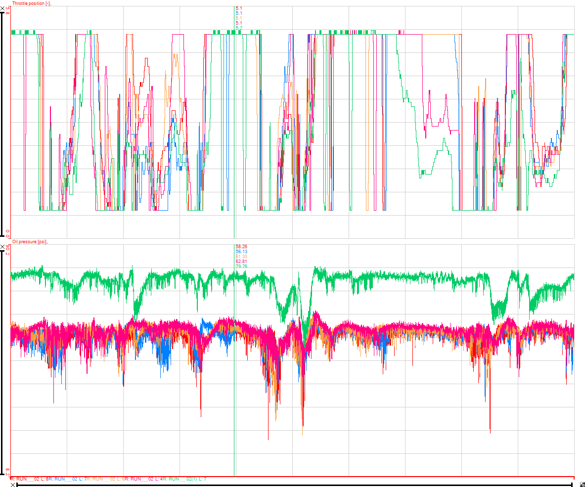

Riddle me this batman. So without numbers on engine compression or leak down and such. Take a look at the following. THe line in Green was my rain race back in March. The REST of the lines are much faster laps in the dry this past weekend. Ever since the march race I've been experiencing oddly low oil pressure measured at the filter housing like it always has. Cold startup used to be 100, but now it's 60. However when I did pulls it went into 60's so I figured it should be ok. However when comparing the data, it tells another story:

Lower oil pressure under all conditions usually means there's a bearing on its way out. Get an OCA done on the oil and see what the metal content is like.
Hopefully that's not the case but at work I deal with this exact scenario about once a month or every other month and almost every time it's a bearing that's about to say sayonara.

Yea that looks like a bearing issue. I would check before you pump a bunch of metal through the motor.

As the other two said, likely bearings. Get an oil analysis done, or cut a filter open. It'll tell you..

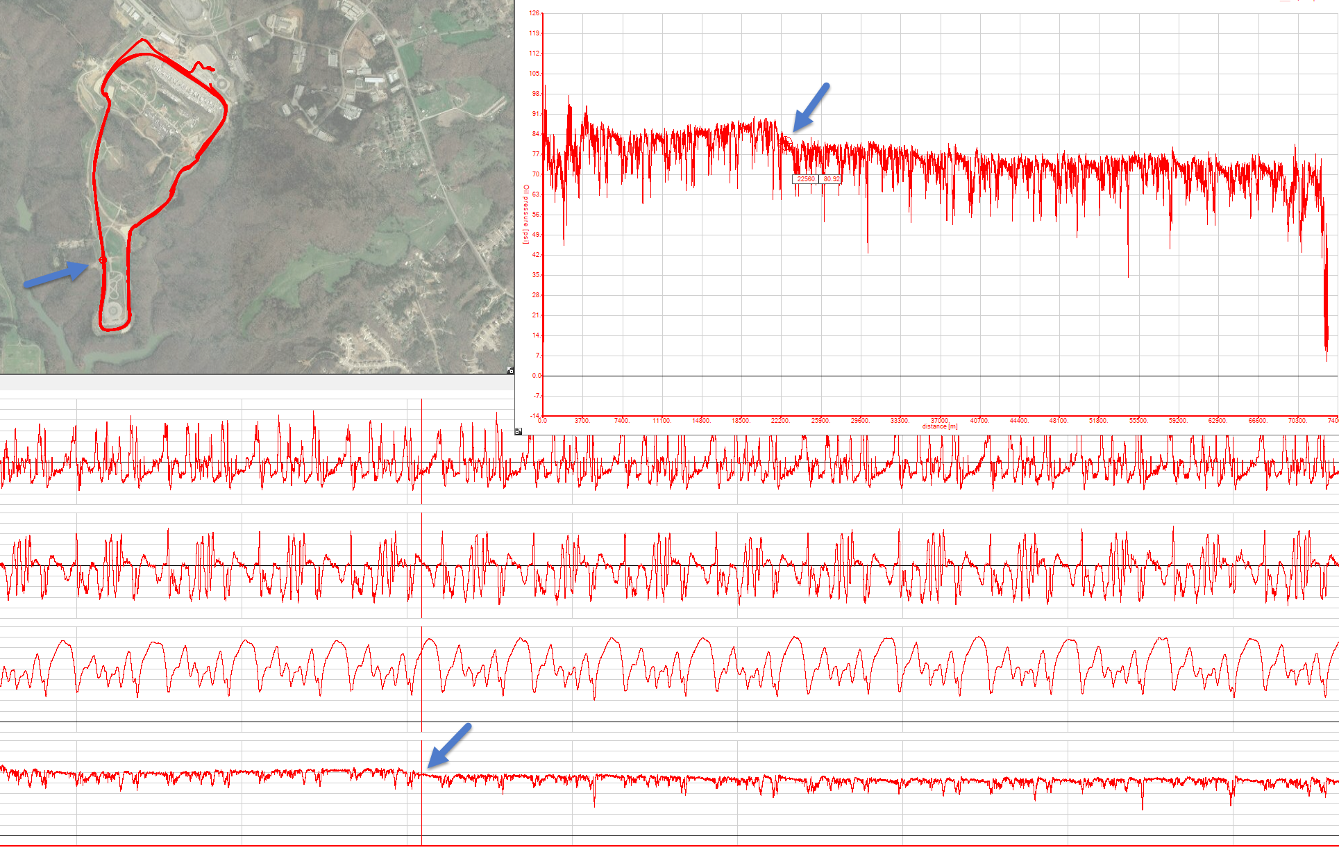

Ahh I see it now. So this is the rain race in March when I kept blowing out that rear PCV fitting. It went out of spec on the back straight looks like, building up speed in 4th.
