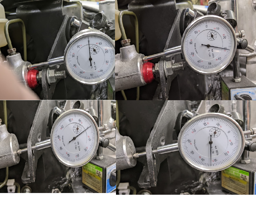

I actually have the Grimspeed brace and I don't know if I felt much of an improvement. I preformed a similar test that shows it does have a very small improvement of 0.004 in (0.1016 mm) Can you feel that as a driver or is it more physiological?
From this result, I will probably stop using it as even the brace flexes by it's self. (Free up engine bay and driver corner weight.)
With - 0.030 in (0.762 mm)
Without- 0.034 in (0.8636 mm)
I've been ready to install mine for months, but I've been cringing at the idea of flipping the negative cable bracket that already has a broken loose copper strand. Maybe I should just ditch it and also ditch the catch can on the other side that never catches anything.
Thanks for sharing your experience.
