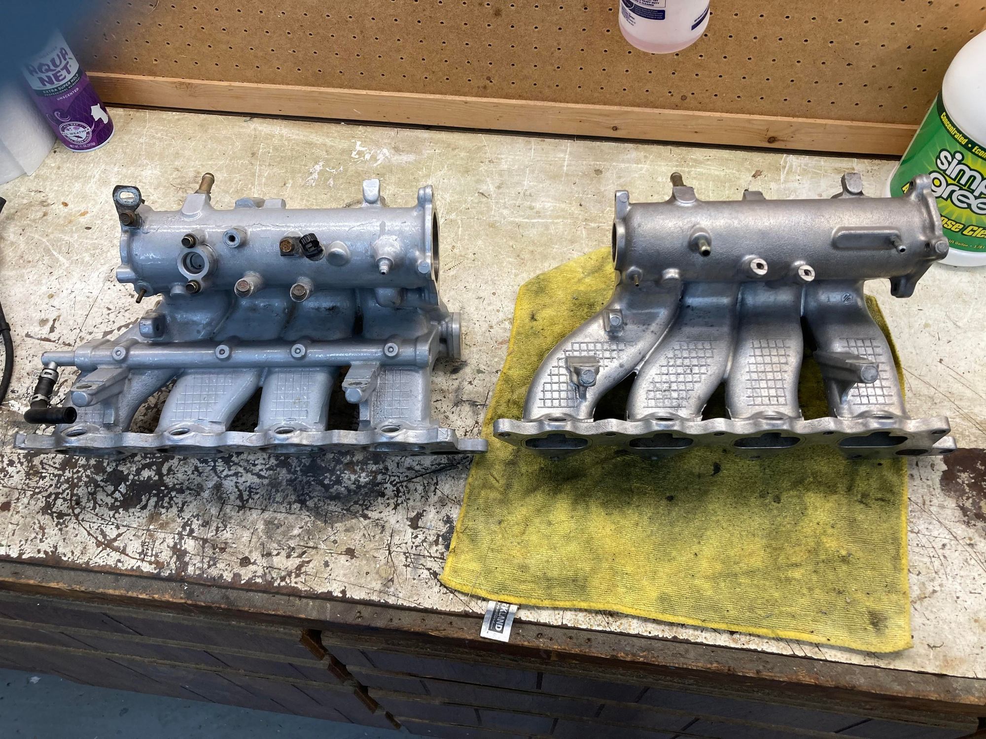

You can have my old stock one. Although I did so some light runner work on it so not sure if that'd be an issue.
FYI the earlier evo IMs come with much less of the unused stuff, no EGR either. I picked up this Evo 4 one from the UK for under $100 shipped. I believe either the 5 or 6 added the MAP sensor directly to the plenum like we have. There are a few versions and it's hard to figure out which versions came on which cars but if you go on UK ebay they're all there for pretty cheap.

Would be really interesting to see a flowbench of the older manifolds vs the newer.
From what I can tell the inside of them is identical with the exception of the EGR passage.
