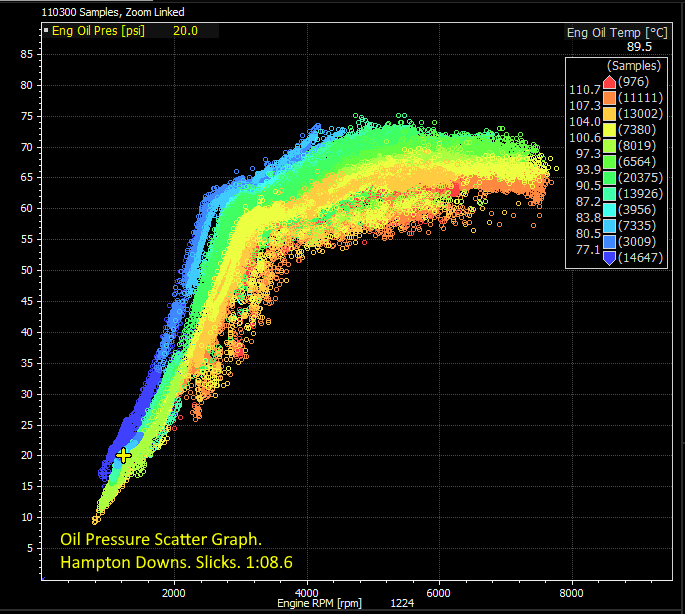

First day out on slicks, I got one session in before it started raining.
Car went really well, very little oil in the catch can (less than 100ml) since making those changes.
PB went from 1:10.3 to 1:08.6 going from semi slicks to Yokohama slicks. 260/640R17 size.
Just need to sort out my brake temps now, and more chassis/suspension changes to help get rid of that front end rumble when commanding too much steering angle.
I'll be playing with shock settings, I'm running 3-way Reinharte's at the moment with 12kg front and 18kg rear. Will likely change the rear to 22kg or 24kg springs to get the balance better.
My local track (Hampton Downs) is smooth and clean, so heavy spring rates seems to work well here.
Oil pressure is still perfect, no oil surge even running on slicks.
Note: My oil pressure reads lower because I have the sensor on the end of the mains gallery (#4 cylinder). And I'm running a Tomei Thermostat killer which increases the pressure drop as all oil is forced through the oil cooler. 65psi at the mains is around 85psi at the oil filter housing.
The small "dips" in the oil pressure is from the Mivec activation/movement.
Old Oct 16, 2024 | 04:58 PM
LetsGetThisDone's Avatar
Joined: Oct 2013
Posts: 15,973
Likes: 1,629
I would bump your regulator up a bit, another 10-15psi wouldn't hurt anything. Get it to around 100 at the OFH, more pressure to keep the bearings happy.

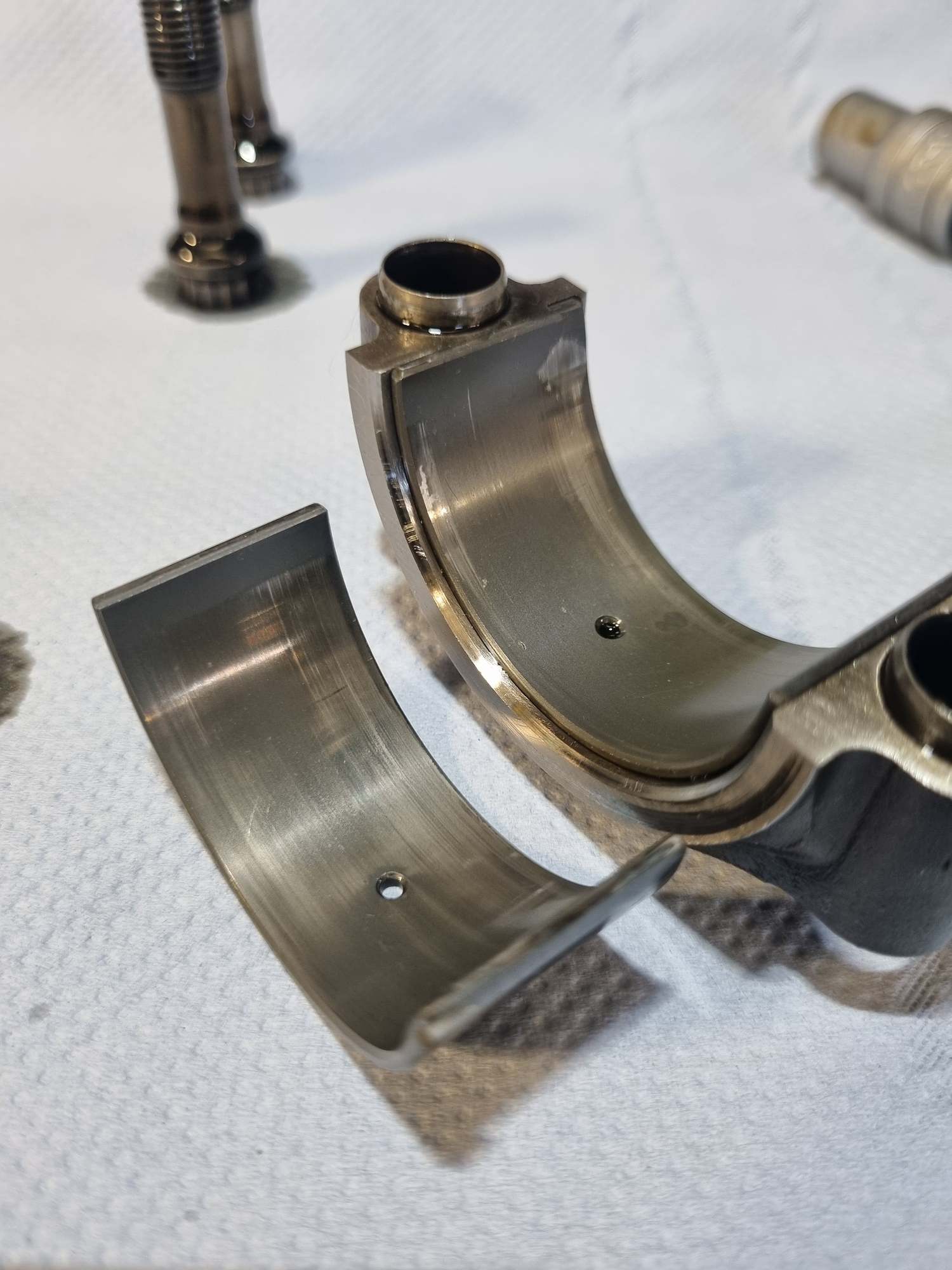

Yup agreed, normally with new oil the pressure comes up a little.
Pics of the #4 big-end bearings about 4 weeks ago. These have done ~10years and probably 50 track days.
Only moderate power at around 380-450whp, but i'm very happy with how they look.
Old Oct 21, 2024 | 02:30 PM
Joined: Oct 2013
Posts: 15,973
Likes: 1,629
They look okay, certainly for the use. But the wear on the cap side shell indicates possible insufficient oiling.
