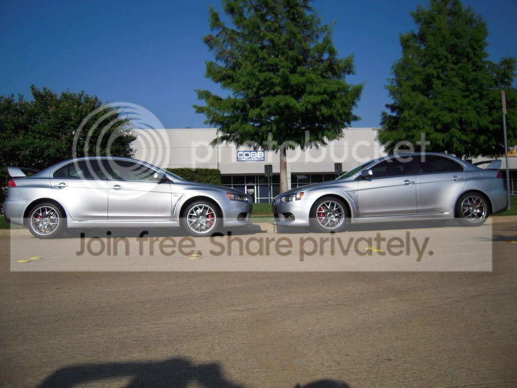

COBB Springs on Chris Fleming's MR (before he went to AST) vs Mar Berry's Stock ride height

eibach looks raked.

Kevin, do you have actual drop numbers for the Cobb springs? They're rated lower than the Prokits but from the pictures it's pretty obvious they aren't. They also look to have a slight front-bias rake to them vs. the rated rear-bias rake. Thanks!

both are still not low enough for my taste, but the pro kit is definitely lower than the cobb.
