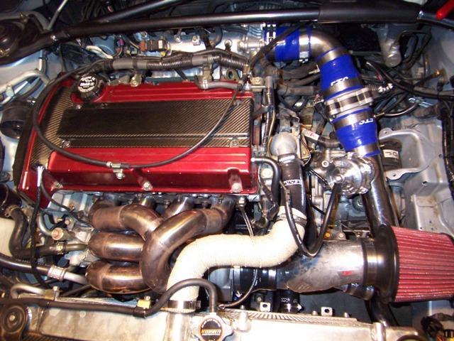

Car is running rich, then lean, then rich again......still working out the tune. Long process, you know. Thought I would post a pic of the setup! Tell me what you all think! By the way i have some of my old setup if anyone is looking for some parts. Here is the link if anyone is interested. http://www.alaskamotorsports.com/for...ad.php?t=41197

So which blow through setup you using? I talked w/Chris from Mellon tuning on here about it and he said its a little bit tricky to get it setup and such especially when the weather changes. Looks pretty good, hopefully you get the bugs fixed and such. Who's doing the tuning for ya?

im using the maf translator, its kicking my butt! I'm doing the tuning myself.

I used the MAF-T setup on my TT stealth with shares a very simular ecu/mas as the EVO. The problem is that it sends the ecu a fix baro and ait so it doesn't compensate for temp changes and the AFR can drift off especially if the temp changes 30+ degrees a day. I've tuned some EVOs with the MAF-T since then and the customers reported no noticeable ill effects related to this so maybe that's a problem of the past.
I've personally tested the stock mas up to 565awhp thus far and plan on pushing it further when my BR shorty/head/cams arrive so I don't see a good reason to go to the GM MAF yet and at that time I'll personally just go to the AEM EMS and do speed density instead.
