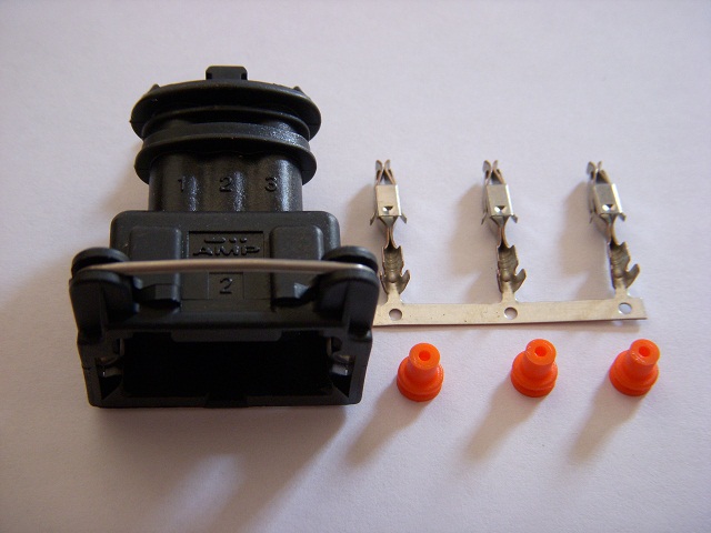

Another update: While the 4 bar MAP sensor tests fine, when the cannon plug is jiggled the car dies, so it seems we have found our issue!
So here is where I would like some input. Would this indicate the MAP sensor itself is bad and needs replacing, or that the cannon plug needs to be replaced, or both??????
What say you?
Old Jul 8, 2011 | 12:28 PM
  #36
Ryan.Kauz's Avatar
Joined: Jan 2008
Posts: 1,155
From: Your mamy's bedroom
Guys, I need confirmation on this, if it is the MAP sensor harness that has gone bad, will the harness that SpoolinUp sells work for this?
It looks quite a bit different than the OEM MAP sensor harness.
http://www.szabaga.com/store/diyconn.html
