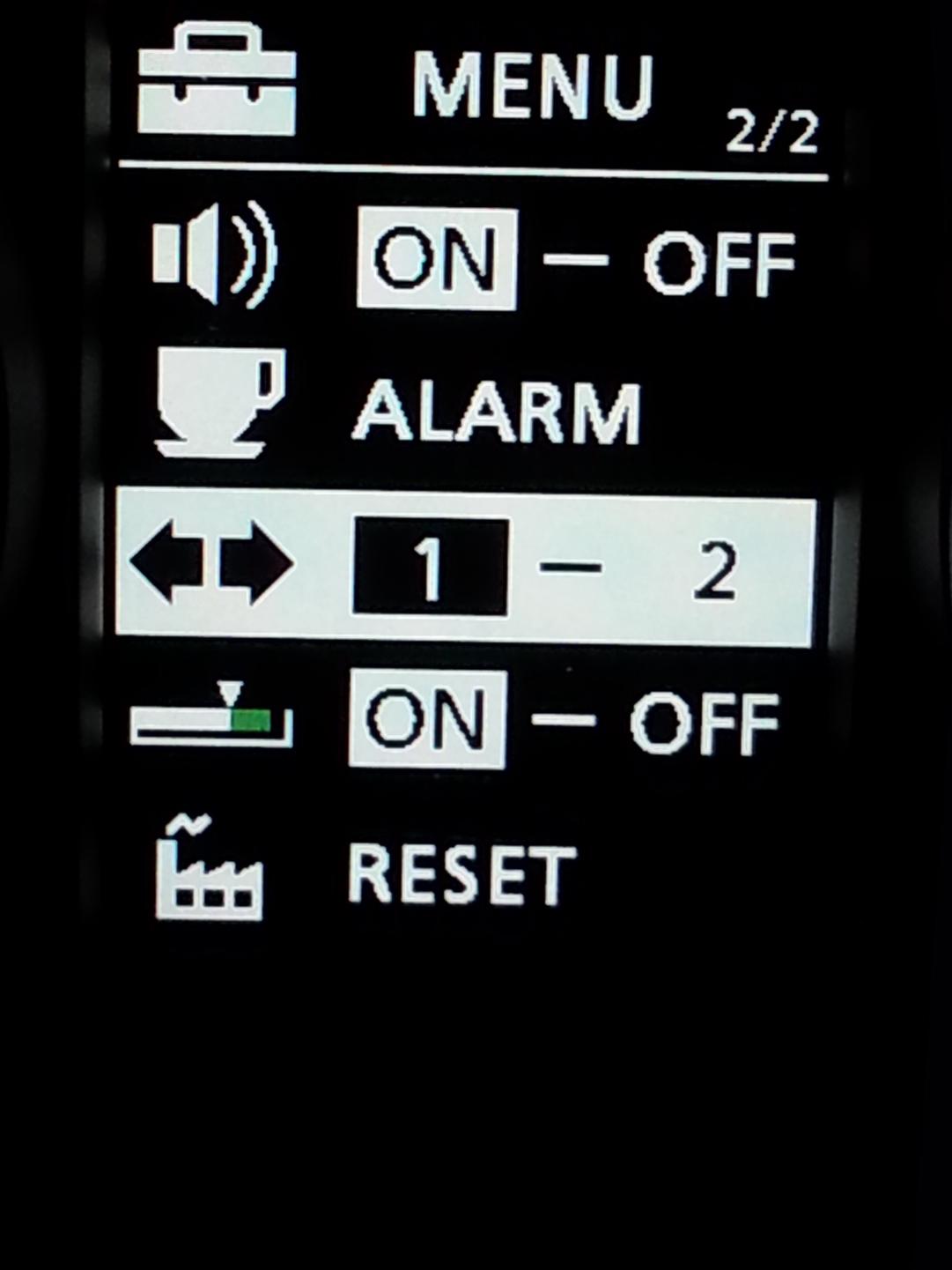

Changing turn signal tone
Navigate to the second page in the settings menu. The one highlighted in the picture is what your looking for to change the sound of the turn signal. Hold down the info button to change the selection between 1 and 2.

So ahh...half serious question...whats the Coffee alarm?
Alarm for switching drivers on a roadtrip. Also you silly automatic folks, I've been playing with the menu for awhile without knowing people couldn't find it. Also neat feature hit your washer spray once and quickly (stand by for a surprise).
