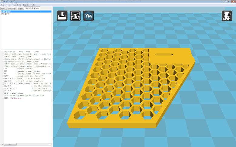

I wanted to re-enforce/stablize the Z-axis' bearing-rod support plates, so I drafted up some prototypes >
Here the virtual prototype is being "sliced"/prepped for printing.
Sending to printer.
Finished print.
It goes here >
Installed >

I'm still getting some Z-axis offset/shimmying..
(from what you can see on the side walls of the holder.)
Guess I'll have to do some tweaking on my Z-axis re-enforcement plates later tonight.

Just finished redesigning the z-axis plates.
(Old on left, New on right.)
Close-up view.
Basically filled in some of the holes to stiffen up the plate. Added a bit more area toward the back and trimmed off all the 90° corners.
Here it is installed.
I decided to add a metal spacer to stiffen it up even more.
