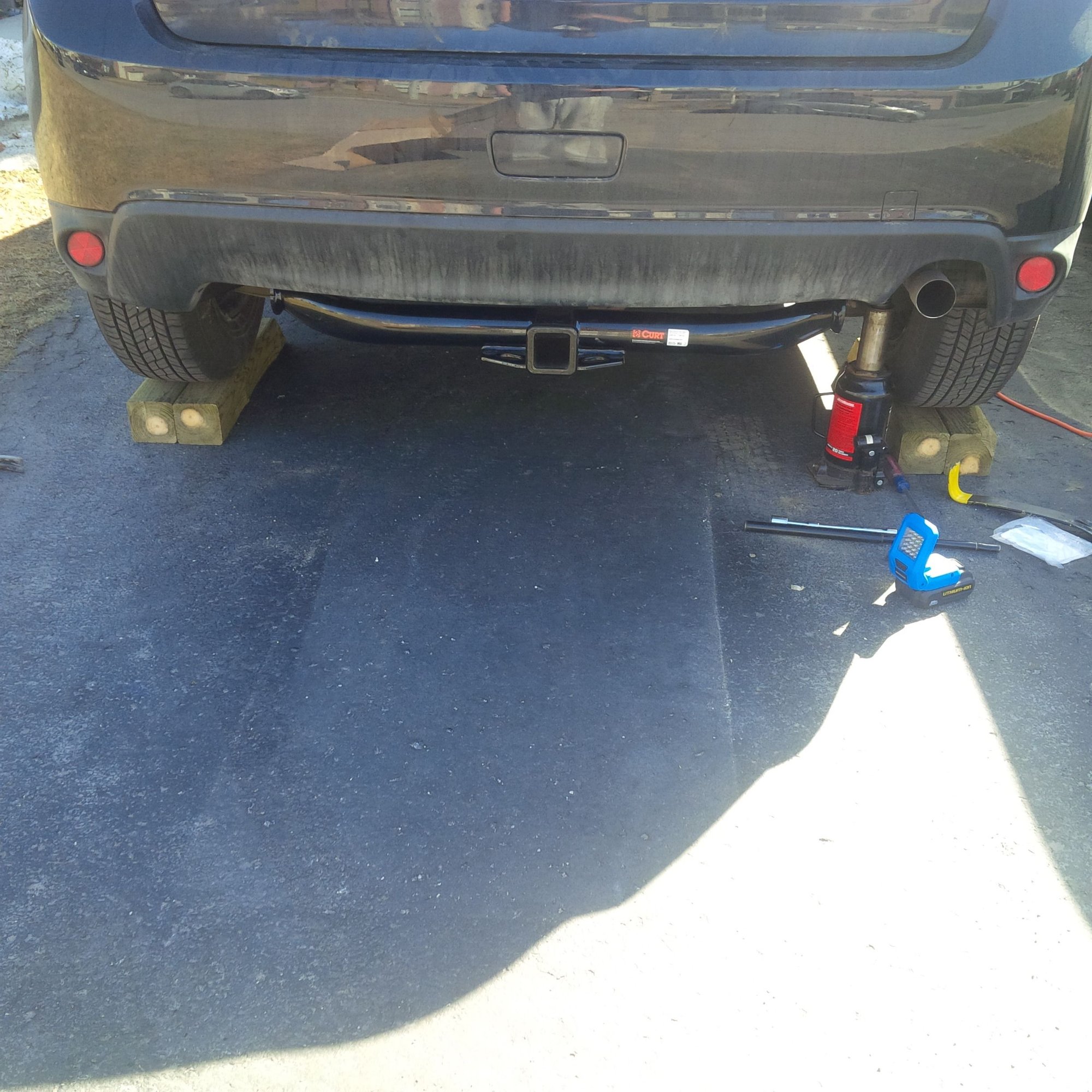

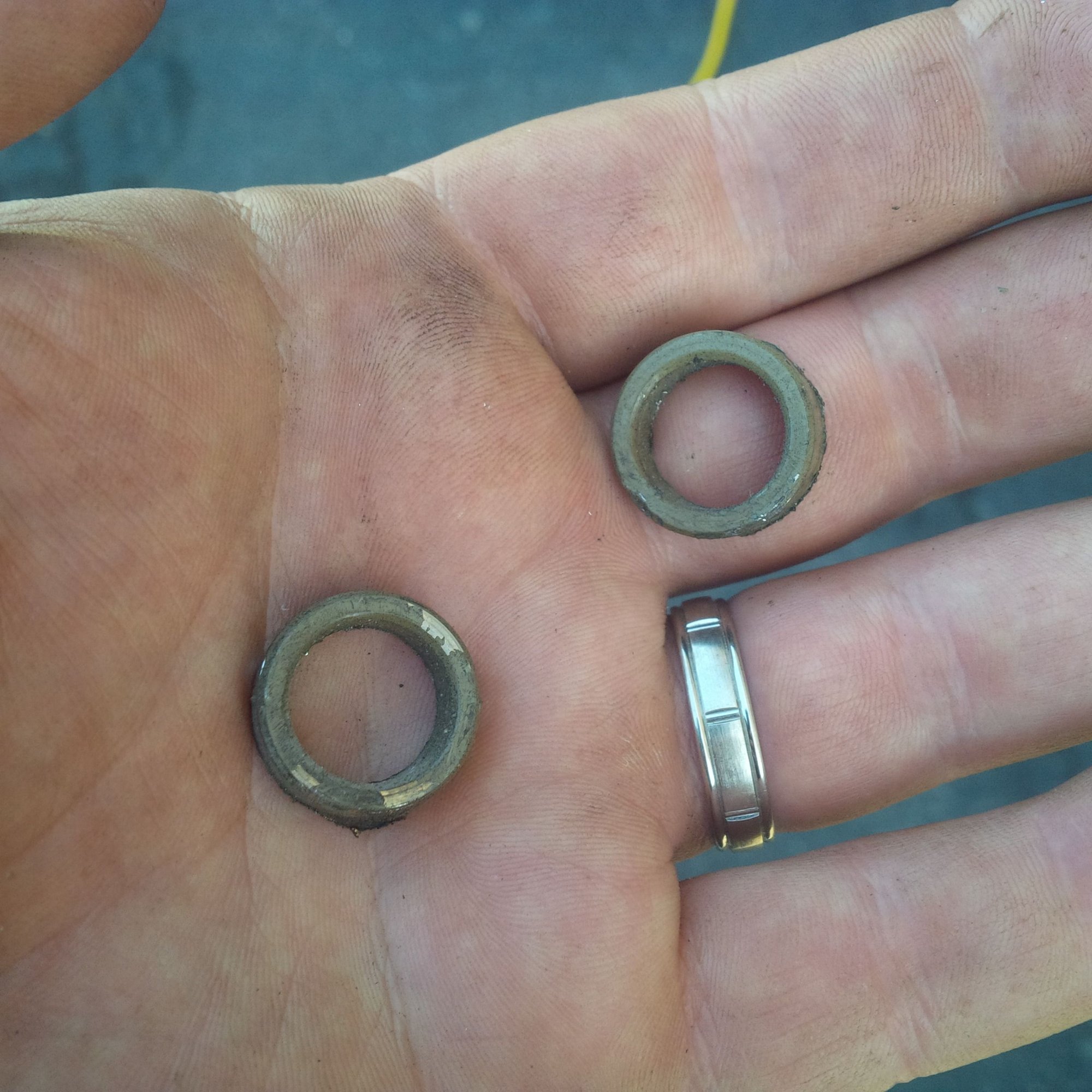

I said screw it, cut the lip of the bungs off with the reciprocating saw
, not the welds, used a jack and got it in, took about 1.5hrs. Pics attached.

I wouldn't worry about it. It wasn't an issue with the car, it was the Hitch itself as it measured wider than it's supposed to according to others experiences. I was just unlucky, just make sure if you're ordering online that they have a decent return policy just in case. When it arrives just measure the outer points of the flanges where the two bolts go through on each side. It should measure less than 36", if not you'll have the same issue I did measuring 36.25". I don't recommend getting under your car with a reciprocating saw, I'm just very comfortable with that tool. But for any shop with the car up on a hoist could do what I did in 10 mins.
