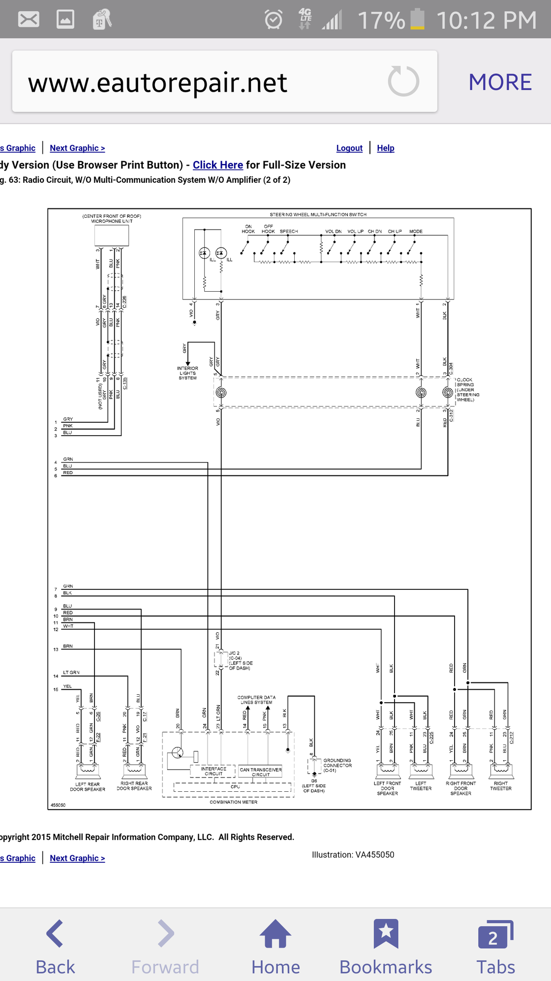

Here are the wiring diagrams for your 2015 ES i will post the 2nd one below this post
