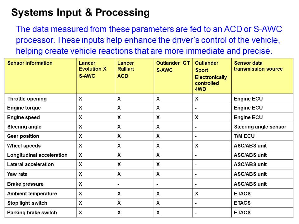

Our 4WD Lock mode is really a misnomer and causes a lot of confusion. It never really locks. A fully locked differential can only be used in low speeds (you would compromise cornering ability). 4WD Lock mode in our cars can be used up to top speed.
The entire system receives input only from four sources: wheel speed, engine rpm, throttle position, and outside temperature (no input from steering wheel position).
For comparison, please see the attached image for inputs taken in the more advanced systems.
Are you sure about no input from steering wheel? Wikipedia says that torque at the rear wheels is reduced by a smaller degree through corners, so system must know that car is cornering... It takes data from ASTC, which monitors steering angle...
And are there any sources except attached image confirming temperature factor? To be honest, I never heard about it, but it sounds nice
My source (the table) is also from Mitsubishi Motors so, I can only be as sure as the source (it is in the file now you also have, entitled "Mitsubishi Motors AWD technologies" presented I believe at the same Cabo San Lucas meeting).
The AWC system in our cars gets input from wheel speed (via ABS, TSC sensors) and the wheels rotate at different speeds while turning. I think your argument (concern) can be covered by this.
Furthermore, at higher speeds (this assumes dry road with good traction) only 20% of the torque is sent to the back according to your table. The user's manual states (at least for the US and Canadian customers) something like this: higher degree of wear is expected and the turning ability is compromised in 4WD lock mode. I can look it up and quote the statement, once I get a chance.
These systems are not as sophisticated as that of EVO or STI, some takes input from one source while the other from another.
Mazda's system indeed uses steering wheel position as an input. You (and those, who are interested) might want to watch again the roller test I posted above (from Youtube, conducted by a Mazda dealership) for CX-3 and XT Crosstrek. One might wonder why the test was designed and executed with turning vehicles and why the obstacle was put in the inner rear wheel. If you put the pieces together everything adds up. Adding that if the Crosstrek was manual, it had to use higher engine speed to engage the viscous coupling. You performed roller tests with neutral steering angle position (so were the tests in the 51 minute AWD test video conducted by some enthusiasts).
The temperature control also makes sense (we have a frost warning going off at 3C (~37 F)we all hate) as it factors in possible drop in friction coefficient. All the system has to look is whether the frost warning is on or not. I doubt it will act differently at 30C (86 F) or 10C (50 F), so is not really a temperature reading. This is only my interpretation. Mitsubishi Motors lists the temperature as one of the input sources.
