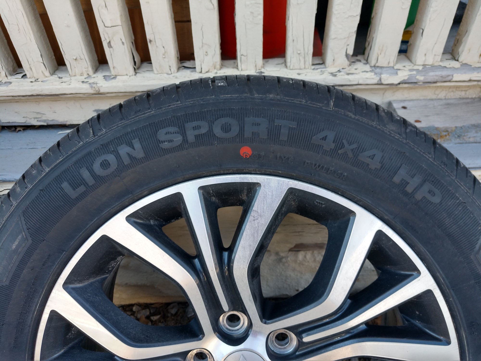

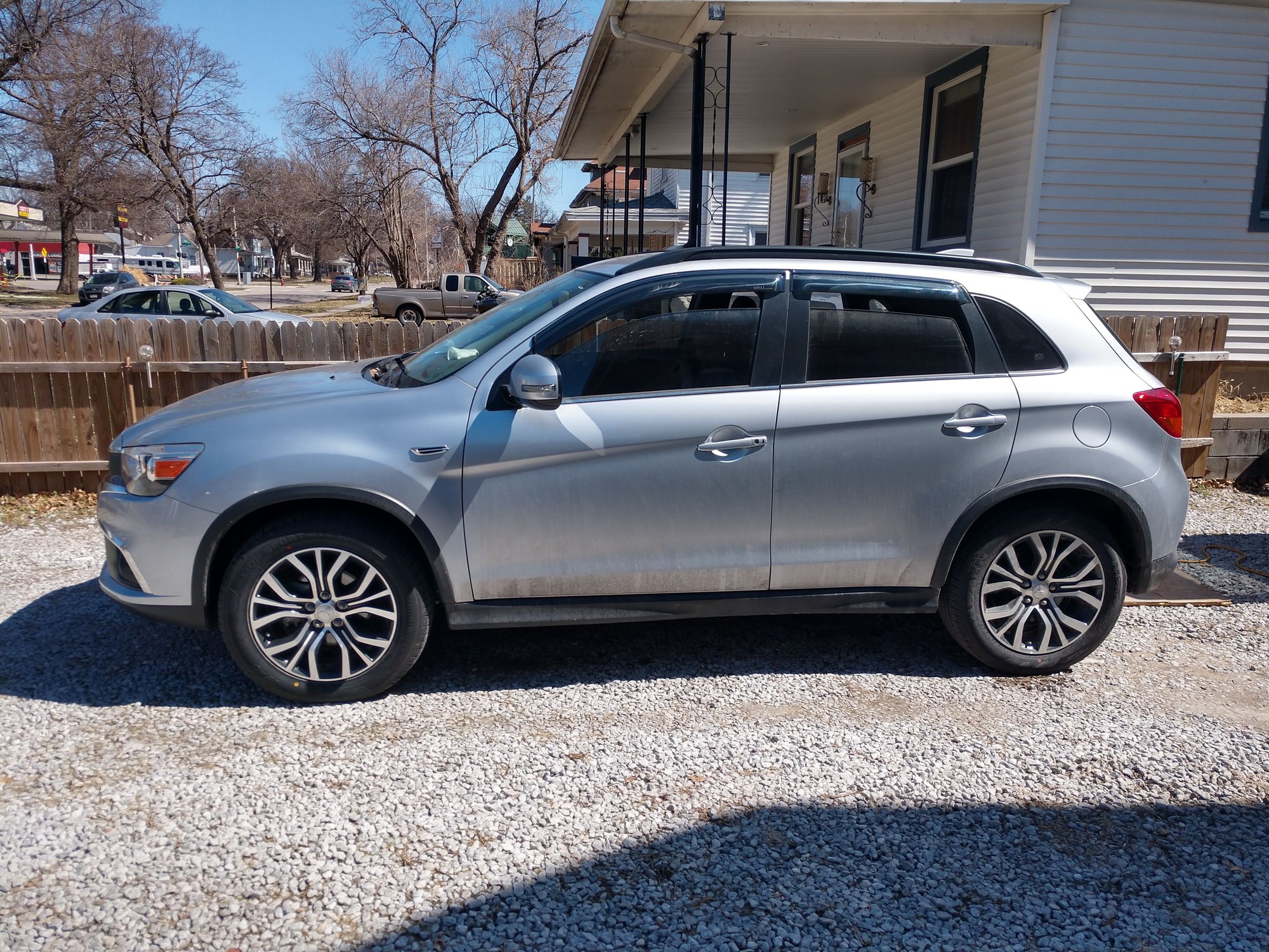

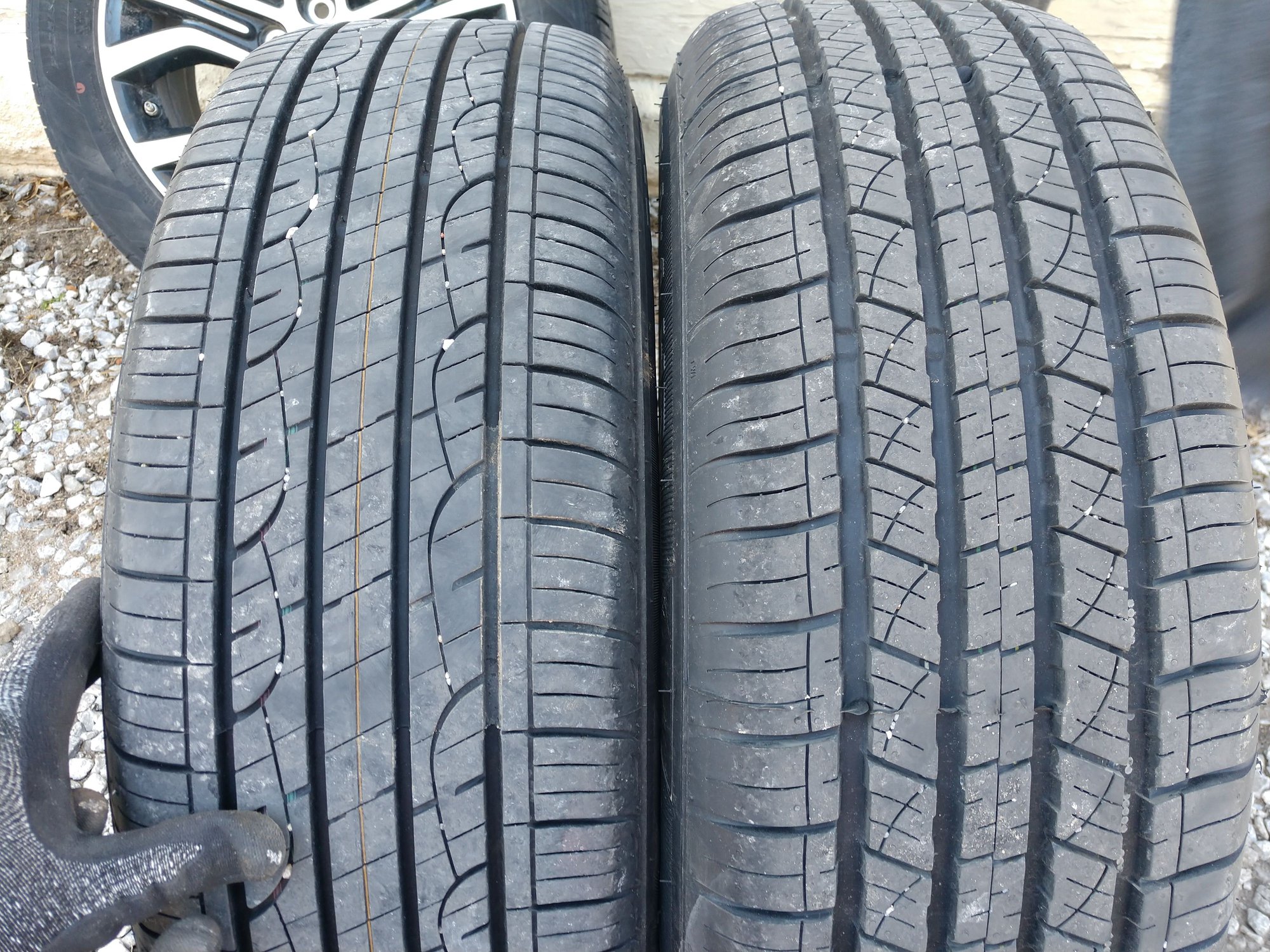

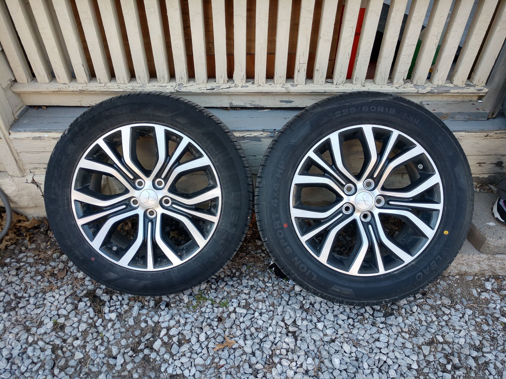

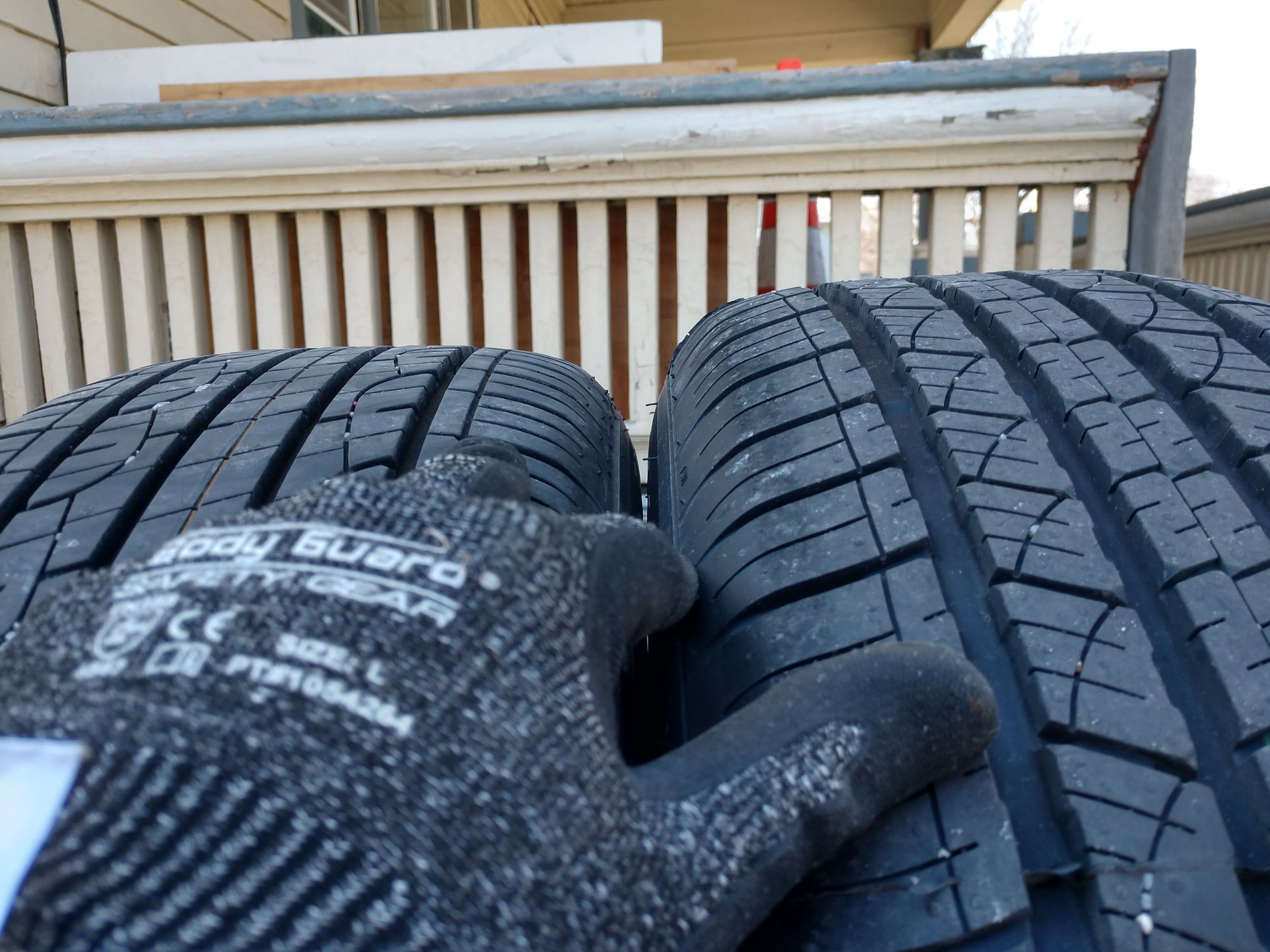

So we had the girl home this weekend from college and switched out her new tires. She's now sporting 225/60R18's. Got some slightly aggressive Lion Sport tires off flee bay, but the price was right and the girl reports back that the ride is much nicer and comfortable than the stockers. They are probably the tallest tires you'd want to run stock suspension wise.
One of the best things I did was to check out the tire size calculator on tirebuyer. Google tire size calculator and you'll find one, but I like this one because it shows a physical difference in the tire size dimensions.
Here's some pics of the tire differences.
Yes, the extra 11 mm side wall height (135 mm vs the stock 124 mm, sorry for metric reference) adds extra cushion to your suspension.The speedometer inaccuracy is not substantial, so it is an acceptable choice. I run 215/70 R16 tires on my car (I should rather say that I opted for the trim that came with this wheel size) with 151 mm side wall height and the ride compared to the stock 18" configuration is night and day here where I live (the long winter takes a toll on the roads and potholes are part of our daily reality these days). The tall side profile also prevents my wheels from curb damage as the 151 mm side wall profile elevates them above the side walk edge.
