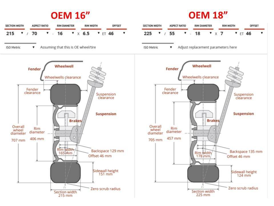

To demonstrate this I am attaching two images generated from the above website: one is showing the geometry of the stock configurations (16" or 18" depending on your model or region) and the other by using the set up used by two of our members (TCNYCS, and Whistler)
2016 Outlander Sport SEL with tasteful mods NYC
Whistler's 2 inch Lift
You may want to keep the position of the brake rotor at the center of the wheel (as shown in both of the OEM configurations) to avoid a torque generated upon acceleration/braking (source for torque steer). By using smaller offset and or wheel spacers you will move the center of the wheel outside and introducing a lever arm for the torque (smaller the offset + wider the tire bigger the lever arm and thus, the torque will be; see the horizontal arrows in TCNYCS's and, and Whistler's wheels). The introduced positive scrub radius will require larger steering effort, more stress on the suspension and steering parts, and decreased handling/stability upon braking. Somewhat less of the problem is that your speedometer will be off (in the two demonstrated cases by only +- ~2.5%).

Damn, that is legit info and actually really clears up some spots for me! I will be playing around with the site. It is neat seeing the difference between there two rims but same tire specs. My only concern is the front tire suspension clearance. I know this can be handled by a bit thicker spacer or different offset rim but would like to stick with my current rims if possible but playing with the tool it looks like a 235 on stock rim should be fine.

Ok right on, I have read other reviews on a 235 on a 6.5 also and a few have also discouraged this. I think the largest I would do is a 225 and that still may be a bit large. If anything, I'd like a bit more sidewall meat. I don't mind the 215 profile but there are not a lot in the all terrain style in a 215/75. After playing around with the measuring tool some more, I think a 225/75 will actually be perfect. Based on the stock wheel specs and what info the tool is telling me, a 225/75 will only move the wheel 5mm closer to the suspension but will fill out the wheel well by around 18mm which I have plenty of room with after adding the fender flares. I also don't mind if I have to do a bit more trimming The only thing is, the suspension clearance is pre-set to 50mm. I do not know if this is a standard measurement for most vehicles or if the OS is closer/further away but the tool is stating I can get down to 15/16mm on a 225/75 with a stock wheel before the tire sidewall makes contact with the spring mount......very cool tool to use
