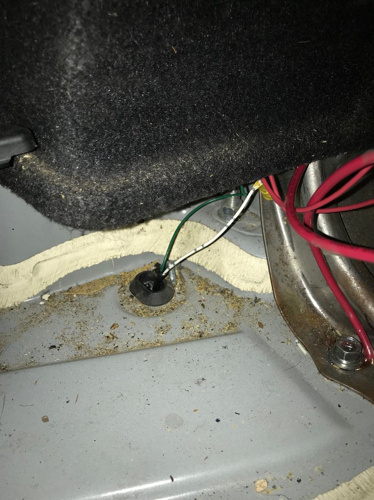

Where is you amp mounted. I put both the sub and amp under the stock floor panel in the trunk. I found a two wire harness under the trim on the drivers side by the wheel well that goes through the floor to a box under the car behind the rear tire. The white wire is switched 12v so I used that as my remote.
https://cimg1.ibsrv.net/gimg/www.evo...3c98d9a6f6.jpg
