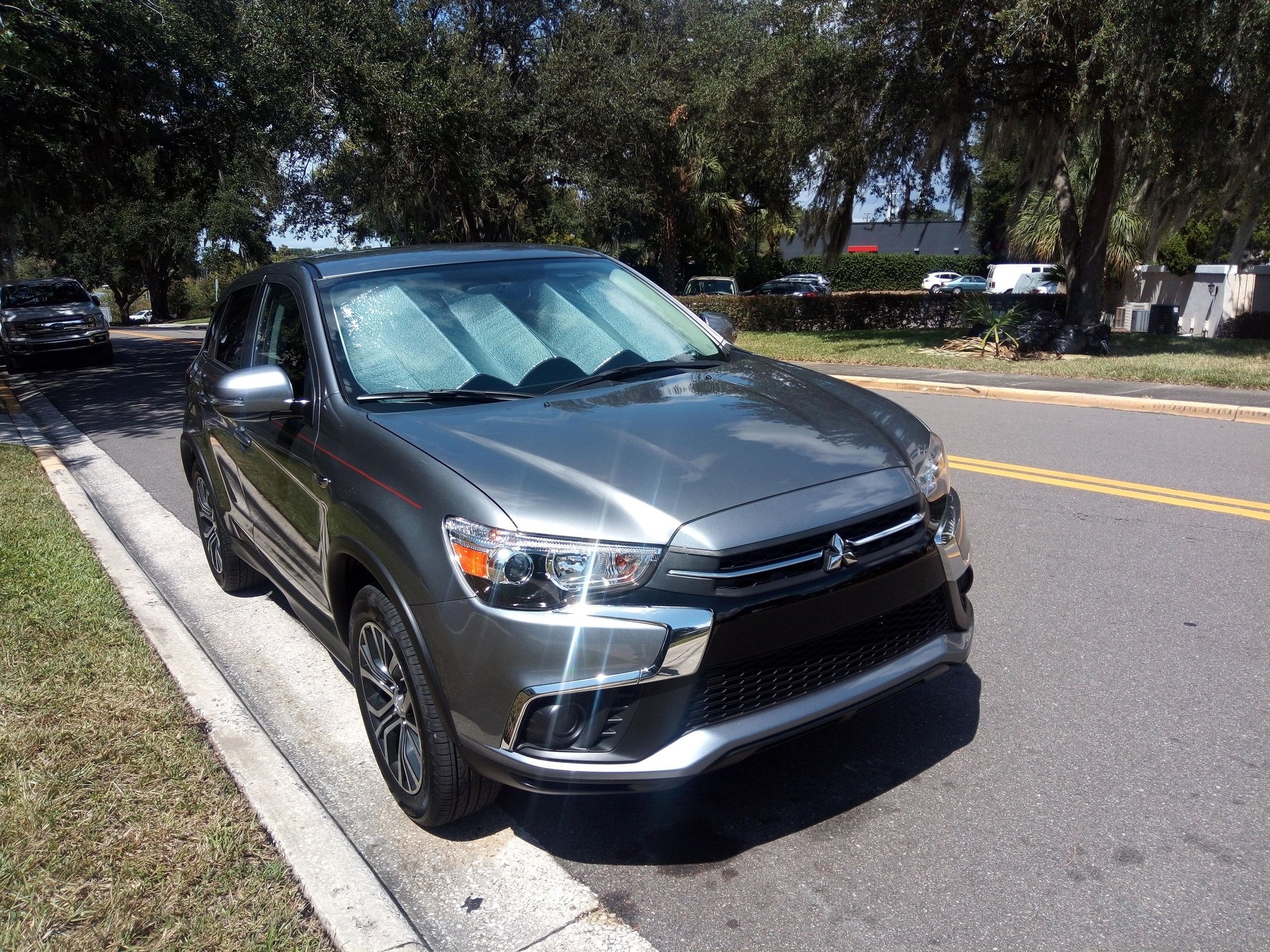

The picture was taken today which is 10 days after we bought it 275 miles on it now, freshly waxed with Turtle Wax Carnuba cleaner wax and Maguires Hybrid ceramic spray wax. We are very happy with this OS and the paint really shines. I highly recommend Maguires Hybrid Ceramic Spray Wax.
